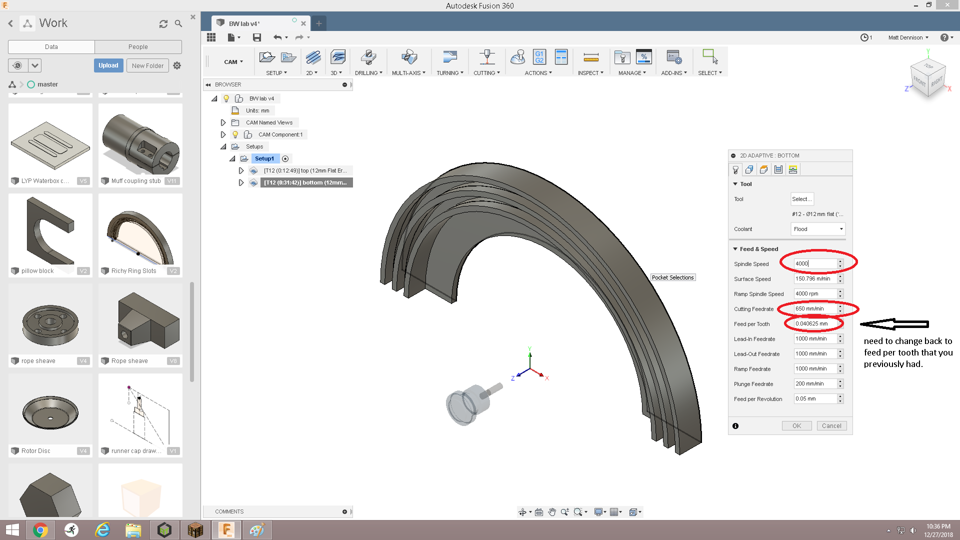

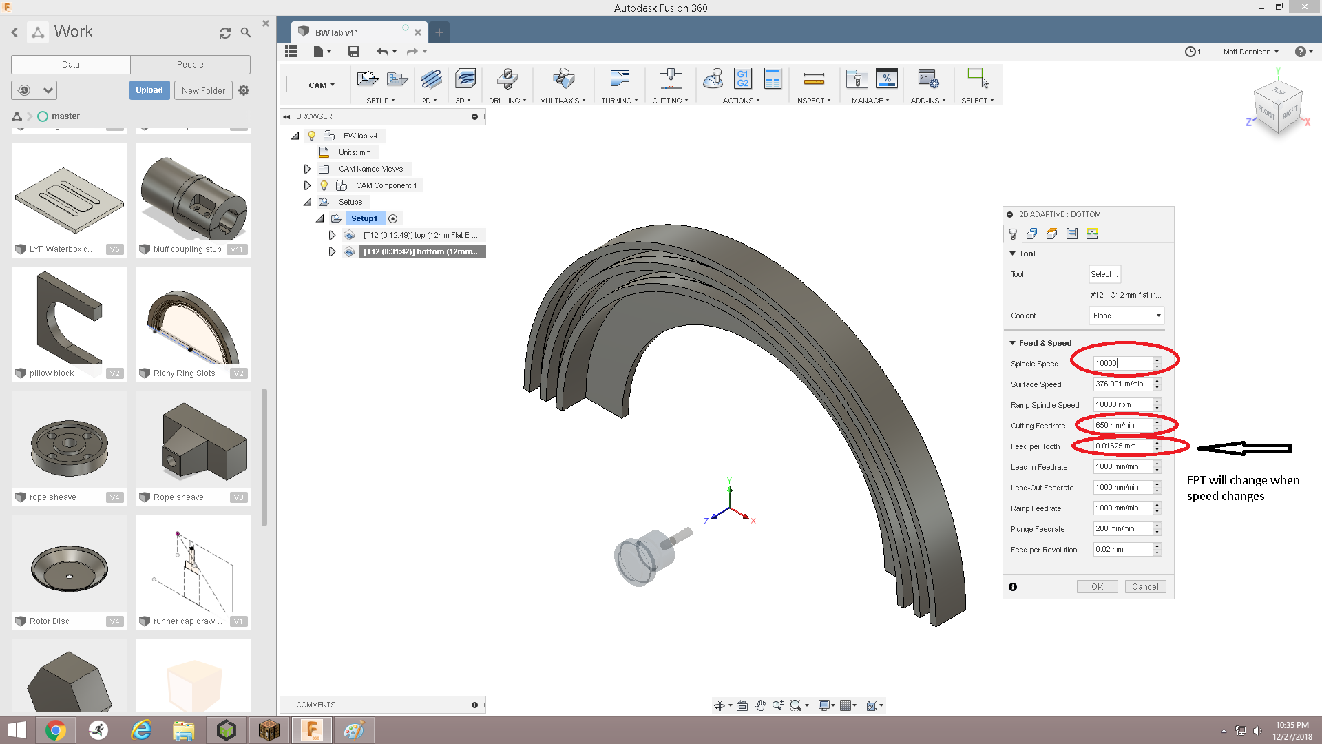

27 Dec 2018 11:28 - 27 Dec 2018 11:44 #122950
by snoozer77
Replied by snoozer77 on topic Odd question for my old machine
Hi Hatch. In Fusion, if you change your spindle speed, your cutting feedrate stay's the same, but your feed per tooth will increase. You need to change your feed per tooth to the value you require, then your cutting feedrate will come down. This is a cam setting, not a linuxcnc one, as Tommy said. Hope this helps. Matt
