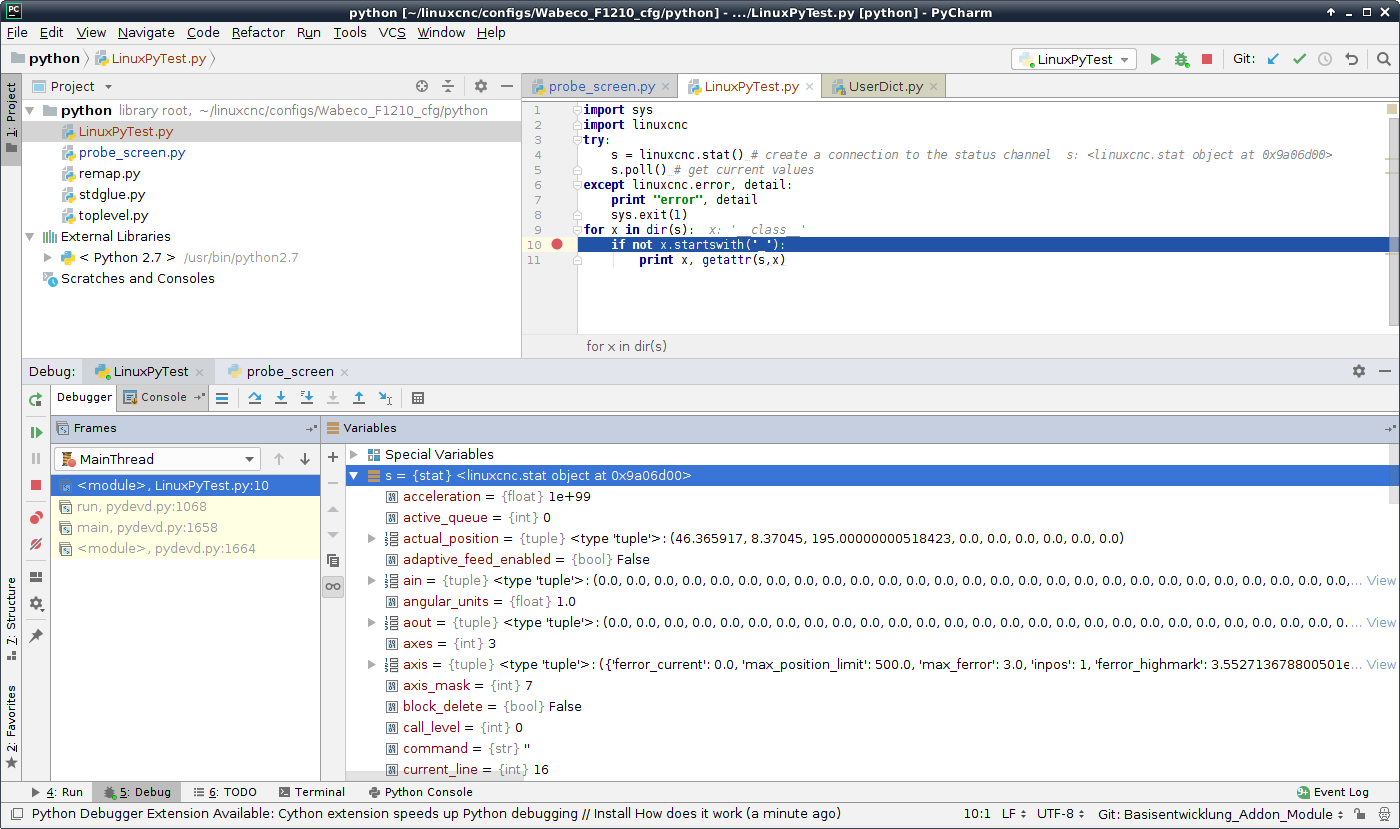

I know there have been discussed a lot Topics around pycharm already, but I couldn't find an answer so for to my specific question.
I am running LinuxCNC 2.7 build from source and as "run in place" version. I installed pycharm and set up all the paths. When starting LinuxCNC from the shell I execute like this
Then I tried out a little example from python interface
This works well, I can debug as I want.
What I wonder now is, how to get it work with a linuxcnc GUI Interaction.
linuxcnc-vm@linuxcnc:~/linuxcnc-dev$ . scripts/rip-environment
linuxcnc-vm@linuxcnc:~/linuxcnc-dev$ linuxcncThen I tried out a little example from python interface
import sys
import linuxcnc
try:
s = linuxcnc.stat() # create a connection to the status channel
s.poll() # get current values
except linuxcnc.error, detail:
print "error", detail
sys.exit(1)
for x in dir(s):
if not x.startswith('_'):
print x, getattr(s,x)This works well, I can debug as I want.

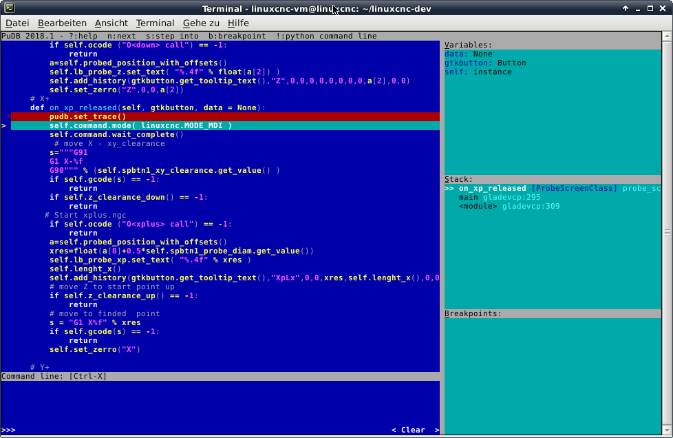

I just search a lot in the net with your hint of using "pdb" for debugging and found 2 things which are interesting
1. pudb
This is similar in the usage as pdb, just provides some graphical support. Just usein the code and start linuxcnc from the terminal. Inside the terminal you will get this

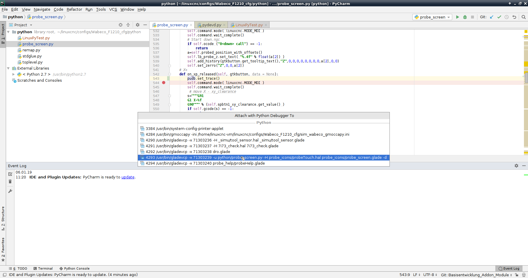

2. pycharm debug "Attach to process"
Pycharm has the possibility to attach to any py process on the computer
But this doesn't work on may current VirtualMachine. It seems that I can not work at all with the RTAI kernel.
1. pudb
import pudb
pudb.set_trace() # at the position you want to break2. pycharm debug "Attach to process"
