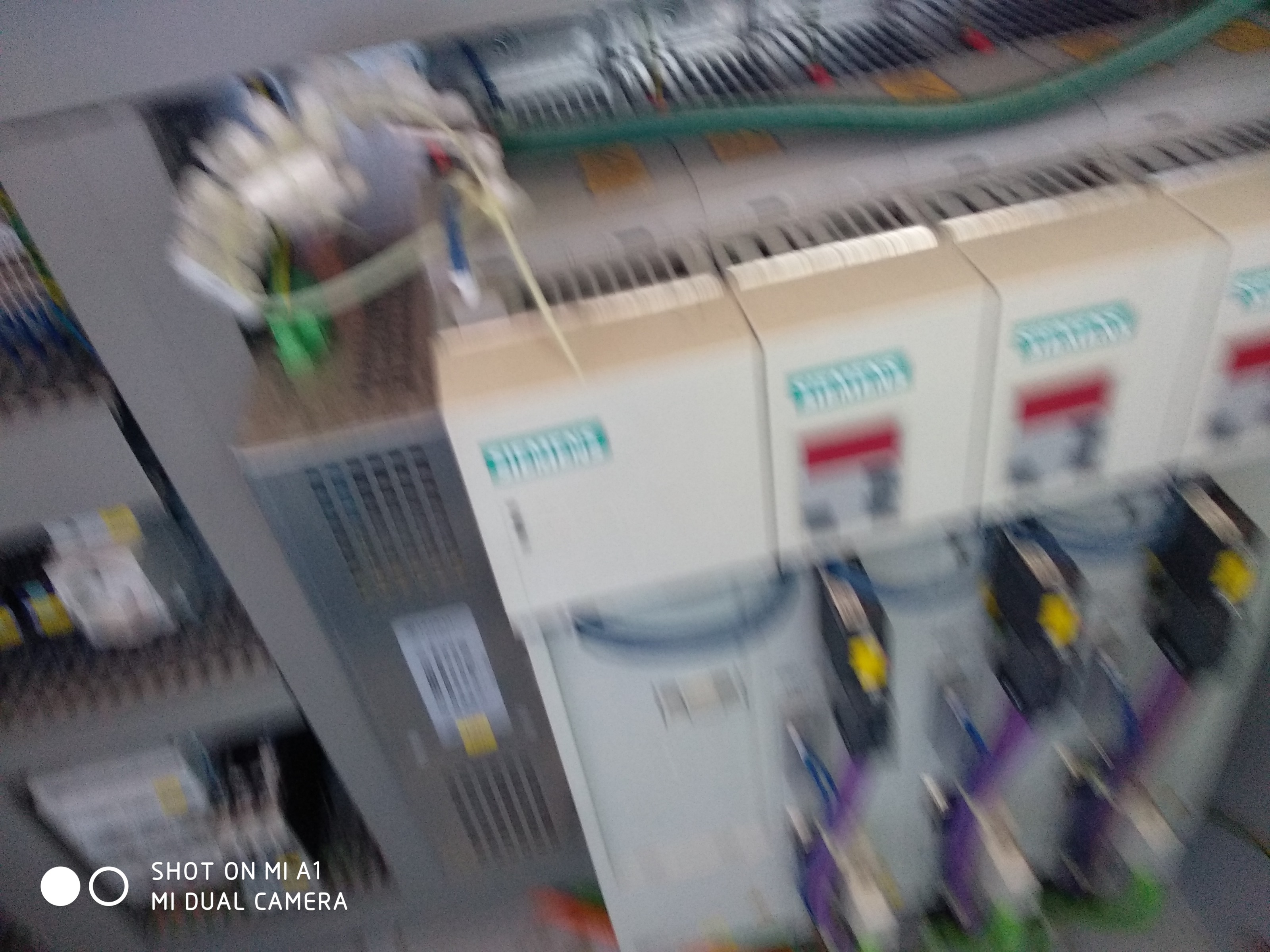

Hi again
i find a palletizer machine with siemens servomotor and matching driver
the price for the motors is little more expensive than the Chinese and i think that the siemens are better quality and worth more
In there labels the type 1FK7060-5AF71-1GV5-Z
If anyone in the forum use this motors and drivers with linux cnc and can share info i m all ears

That code number seems to be the motor.
Do you have a part number for the driver?

The driver is on the electric cabinet and there is no label on it

That won't make it easy to advise.
Is there any indication that the servo drives are controlled by +/-10V analogue signals?

In fact, if you can't find a manual for the drives it is likely to be very difficult to use them.

How about posting some photos of the drive. Maybe someone will recognize it, and know where to tell you to look for the pertinent identifying marks.

Is this any help?

Not really, that's a terrible photo.

Yeah, that photo is almost useless.
But.. Look at the bottom front of the drive (just below or above that green plug in the photo.) there should be a small label there with the part #. If there is no label there, you may have to pull one of the drive modules out of the rack, and there should be a larger label with more info on the left side.
