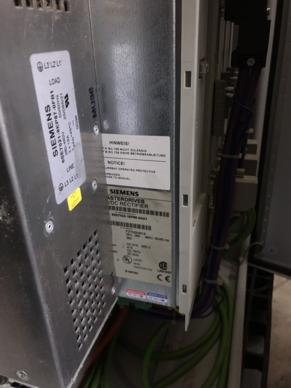

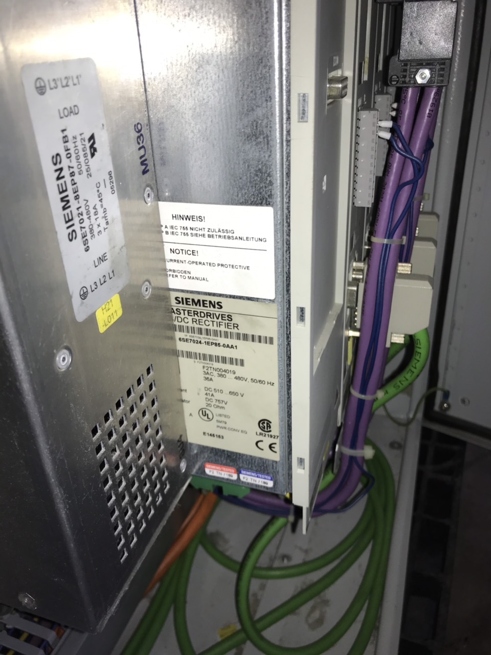

Did you intentionally blur the photo, or what?

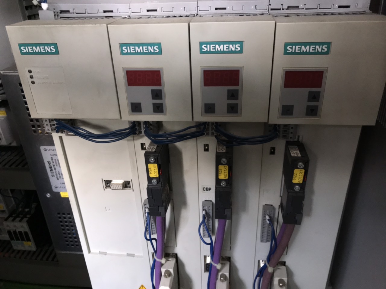

Those are "MASTERDRIVE MC", by the purple lines I can see that they are controller via ProfiBUS. They can also be configured to use analog or RS232 command source.
Servomotors have 1Vpp sin/cos signals, Heidenhain ERN1000 series encoders.

Why sud i intentionally blur the photo:dry:
so can i use them with linuxcnc?

Is this more helpful

You should be able to use them with LinuxCNC, if you can figure out how to configure them for analogue voltage control rather than Profibus.
You would also need to find out which pins/connectors need be connected for analogue voltage control.
