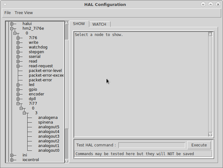

14 Jan 2019 21:11 #124185 by nadine
Replied by nadine on topic 7i77 CR16 red

14 Jan 2019 22:44 #124194 by nadine
I just did that, but it makes no difference, CR16 is still on.
