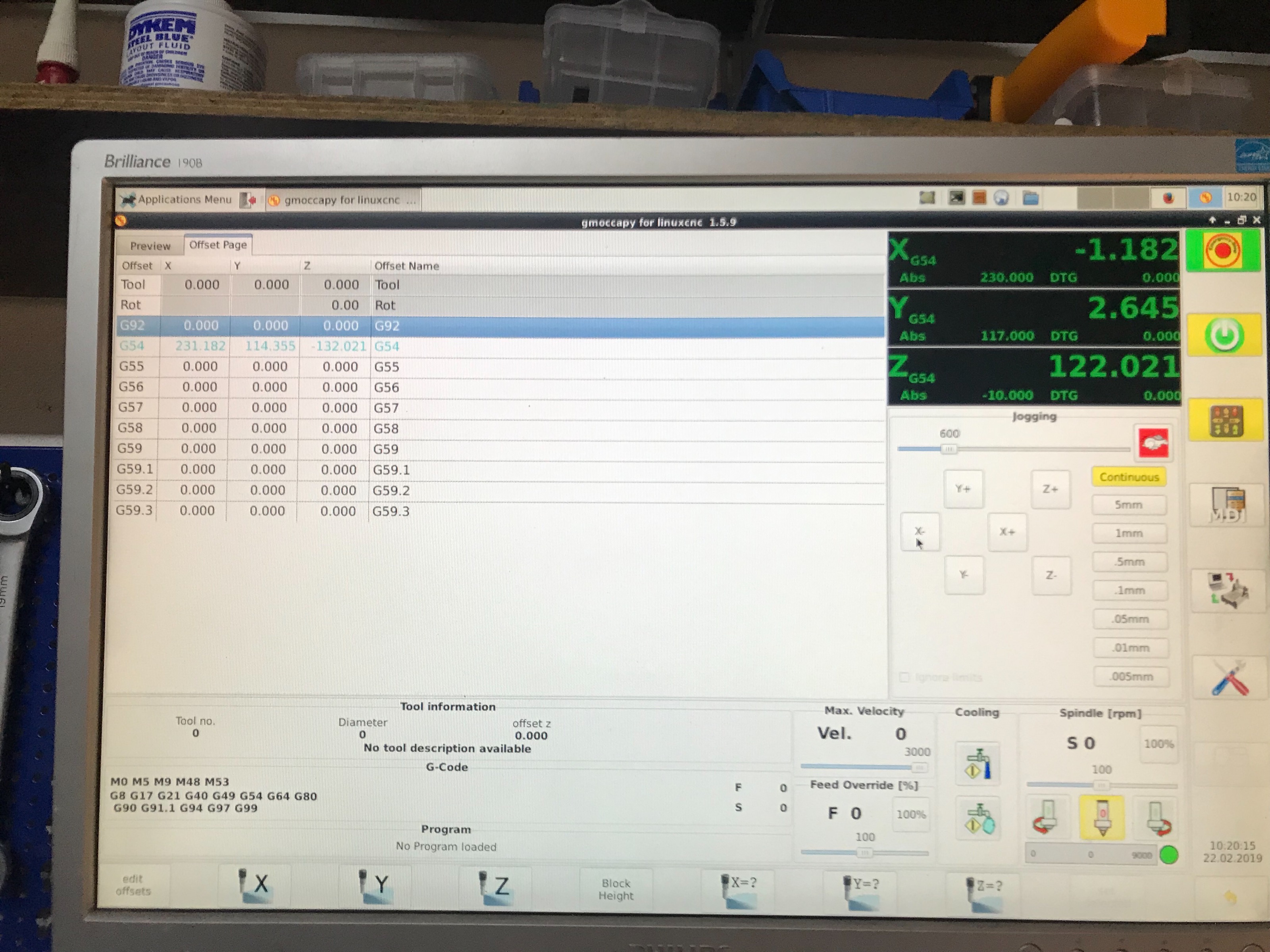

I am in the process of setting up the machine. I have a touch probe that I used to take the g54 coordinates, by probing the vice's fixed jaw.
I also have a tool length sensor, that I can read it in linuxcnc as a pin input, but never ended up using it yet.
I have set the coordinates for TOOL_CHANGE, the machine moves to those coordinates and then I get this: "Linear move on line -1 would exceed axis Z positive limit".
I have checked the G54 coordinates and the Z is -132, and for the tool I want to change I have set the Z to -110.
I don't understand why the line is, if I would have a line number that actually exists, it would be a bit easier to debug..
Please advice!

This is what I have for G92 in the offsets tab

22 Feb 2019 10:56 - 22 Feb 2019 10:57 #126903
by Leon82
Replied by Leon82 on topic Tool length sensor and touch probe with Mesa7i76e
I'm thinking your tool offset value is tool high.
It should probably be the difference between the probe gauge length and the tool gauge length.
So if your probe is 50mm long and tool is 70 your height offset would be +20 since you are setting g54 to your vise
