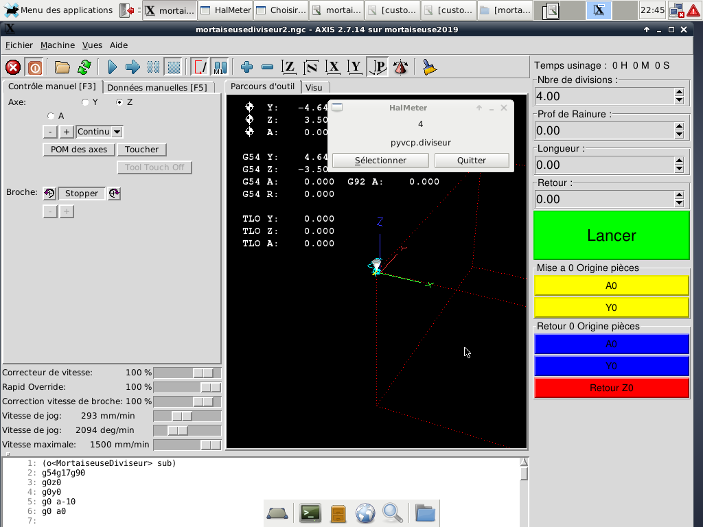

Just to clarify in the gcode you uploaded I see:not
Sometimes the browser adds an encoding error to text when you cut and paste.
#2 = #<_ hal [pyvcp.diviseur]>#2 = #<_hal[pyvcp.diviseur]>Sometimes the browser adds an encoding error to text when you cut and paste.

hello ,
after many hours and test , it' s same result ,I do not know what to try
regards

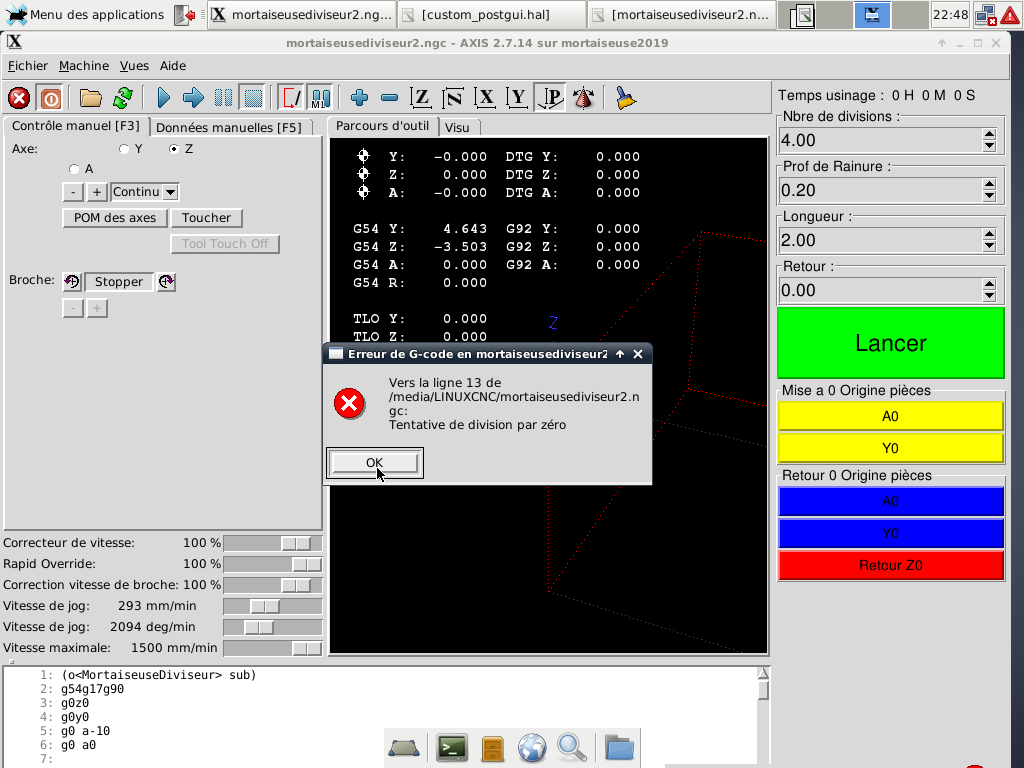

Replied by Todd Zuercher on topic attempt to divide by zero
Did you try the modified code I posted (it seemed to work in my simulation.)

yes but is not ok , i make a another gcode.

I think that the G-code test is the way to go.
G-code access to HAL pins is slightly unreliable if the value changes after the G-code starts to run.
I probably wouldn't send an error message for [divisions LE 0], I think I would just default to 6 or some other sensible number.
