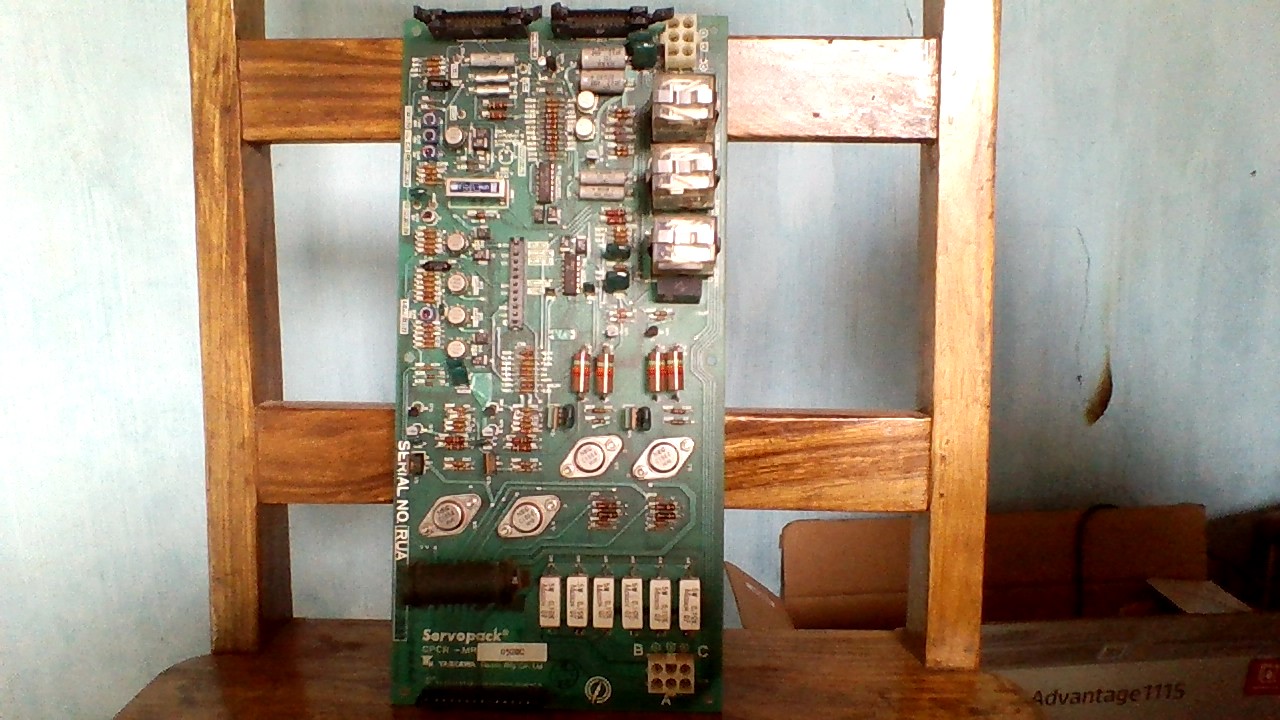

Hello everyone,
I going to retrofit a MATSUURA MC 500V with yasnac 3000g control. The servo drive is Yasnac servopack CPCR-MR 052GC. I could not find the right manual for this drive.It has two 20 pin connectors (1CN and 2CN). all similar ones on yaskawa website have only one 20 pin connector.
This is my first retrofit. I have MESA BOADS 7I77,5I25 AND 7192M.
Please help me put these boards together, connect them to the servopacks and install the linux software.
Thank you all.

I decided to use 5i25/7i77 plug and go kit instead. I was out there reading things and trying to understand but nothing made sens to me yet.
I've tried to install the linuxcnc 2.7.0 and place the 5i25 card in the computer and then connect it to the 7i77 with the DB25 cable. Next I tried to pncconf and got stuck. I don't understand anything.
Can somebody out there walk through the whole process from the beginning to the end?
PLEASE...
