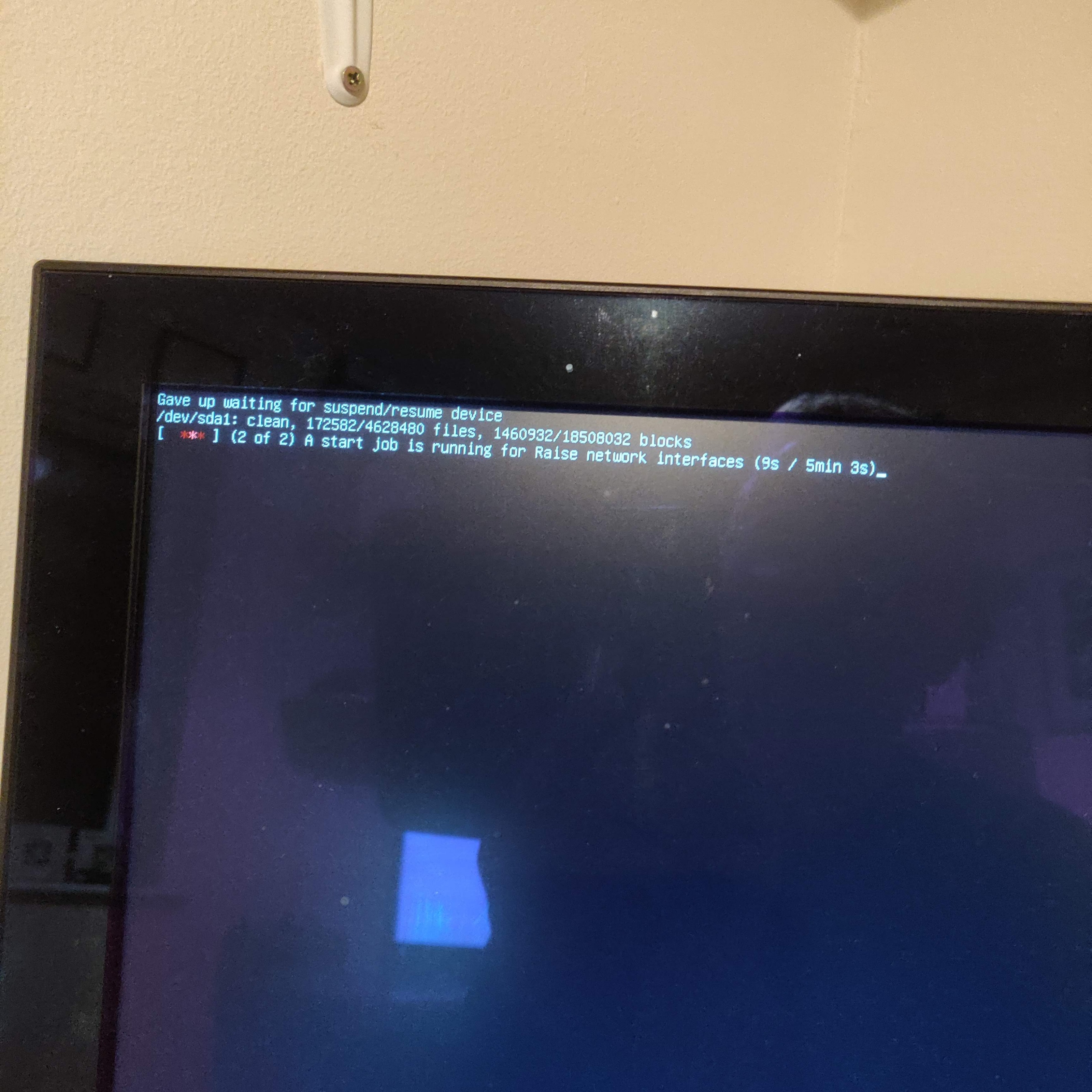

Thanks. I am getting this message on startup. It is taking about 1.5 mins to get past this and wondered if it was the lack of swap file

Yeah that might be it, but it is also waiting for a network connection, and the last part is strange.
To eliminate the first problem regarding swap, you need to open /etc/fstab as root and just delete the line that pertains to the second partition.

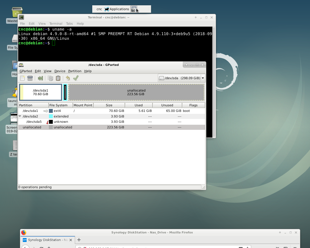

Thanks Tommy. Are you referring to sda 2 or 5?
- Posts: 21986
- Thank you received: 7486
09 Feb 2019 20:30 #126091
Replied by tommylight on topic Does Linuxcnc require a swap partition 2.7.14
That depends, but usually 5 !
