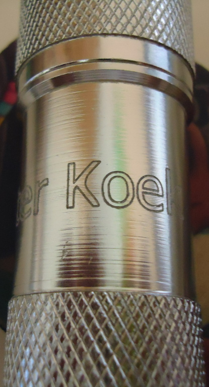

I am using linuxcnc since 2015 with only minor issues (mostly user errors).
This weekend i have installed additional rotary axis (rotates along X-axis).
The first test was to make an engraving on a pocket flash light.
The problem is the letter "K" which does have a rounded corner on the right side which should NOT be there, it should be sharp like all other corners, see photo
The g-code which created the attached picture was stripped from all other letters with only the letter "k" remaining.
When I run this code on linuxcnc version 2.7.14, then I get a rounded corner +/- 1mm radius on the right side of the letter "K"
No matter how small I make the P value of the G64 command, it still makes a rounded corner.
Only when I replace the G64 with G61 then the corner is sharp (as it should be)
Why does the G64 P0.001 does not work for that specific corner (while other corners are ok)?
I don't understand this problem, can anybody help me to fix this issue?

G21 = mm
so G64 P0.001 = 1 micron deviation max (I wonder if this triggers a bug)
What happens with G64 P0.01 ?

I tried different values:
- P0.05
- P0.01
- P0.001
All the same result. Only with G61 I get a sharp corner.
I never seen this problem when using only 3 axes.
- P0.05
- P0.01
- P0.001

Not sure but I think LinuxCNC does not do high speed blending/lookahead
with rotary axis.
Another possibility is really low A axis acceleration settings
with rotary axis.

The interesting thing about that line is that it is a constant-speed linear move with a rotary move. I bet that the corner isn't "noticed" by the trajectory planner.
I bet adding a miniscule back-track in the linear direction would fix it.

I think you are right, the right side of the letter 'K' is a linear move in the direction of the X-axis while the rotary axis is the only one which changes direction (which causes the corner). I have not yet tried to add a miniscule back-track to the line, if it is larger then the P value, then it should work.
@Leon82
In my first post I mentioned that the G61 does not have this problem. The G61 does produce indeed sharp corners.
