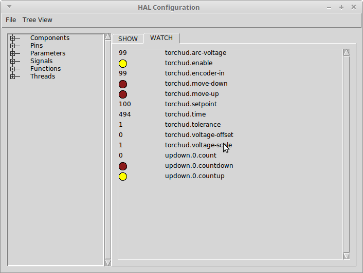

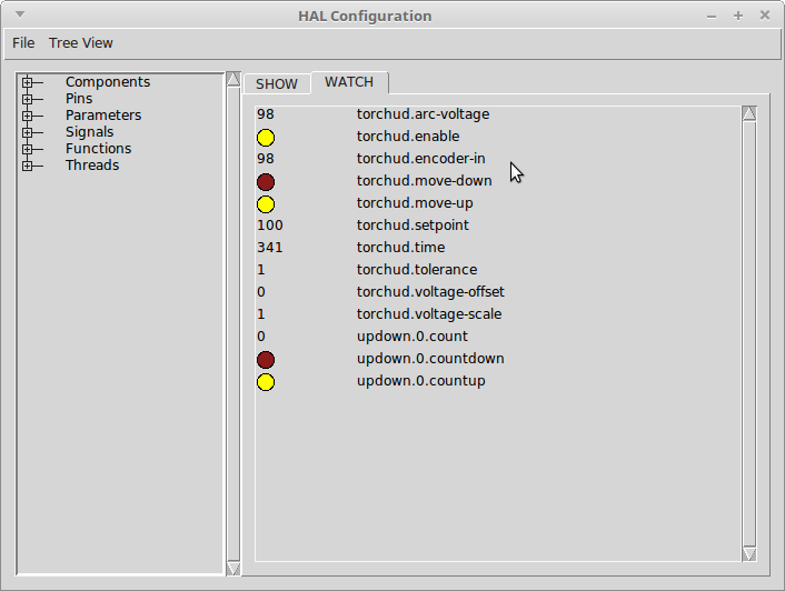

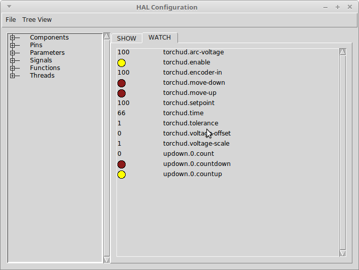

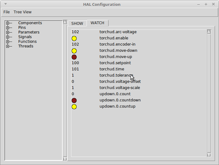

Replied by tommylight on topic THCAD with toma_thc config help needed
It seems to work just fine from what i can test in hal !
Thank you Phill & Co.

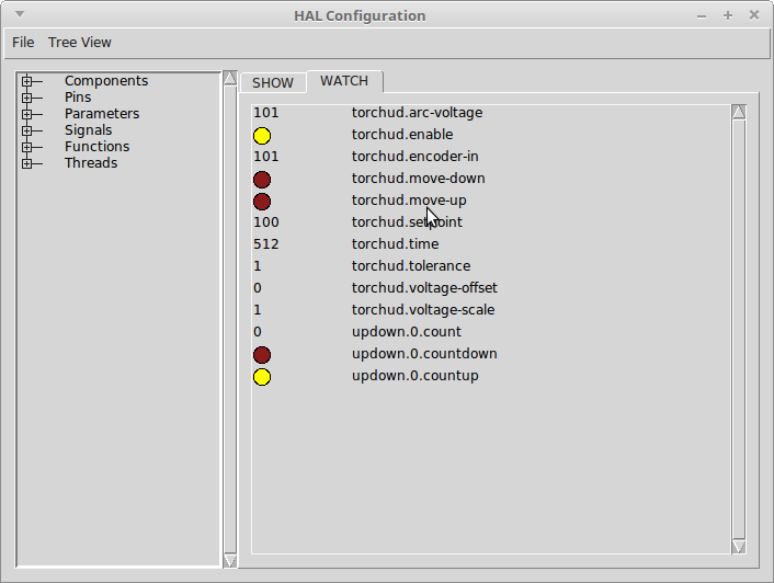

Here are some screenshots of it while testing, had to modify it just a bit as it was keeping both outputs high after reaching the above or below set value and they wound not go off. Now they do, they just neede to be declared as 2 separate if/else. Attached is the corrected comp, in case someone wants to give it a try.
ToDo: add PyVCP panel for it and wire it in hal !

Added provisions to send an ARCOK signal if the voltage is within set limits and they can be adjusted separately. Wired the THCAD to the 7i77 encoder input, got the scale and offset roughly correct and everything is looking OK so far. More testing is in order.
Here is the comp
Here is the comp
