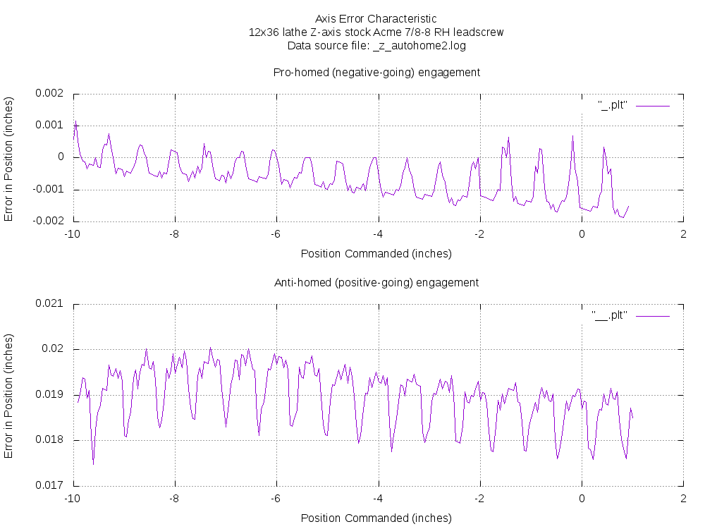

My current project is to automatically characterize leadscrew error and compensate with an automatically generated LinuxCNC COMP_FILE. This has been utterly successful, converting my rough leadscrews from +/- 0.003in positioning errors into +/- 0.0005in repeatability and linearity, including compensation for a sloppy 0.050in of random backlash in the screw and bearing mechanics.
I've gotten everything in place to automatically tabulate leadscrew errors by logging DRO scale readings in a G-code program that moves an axis along stepped locations. The DROs are accurate to 5 microns. I also configured automatic homing of the axis to employ the DRO index, so the homing and error readings are all mutually consistent and automatically repeatable across machine shutdowns, and across characterizing versus compensating startups. Here are plots of the characterization readings:

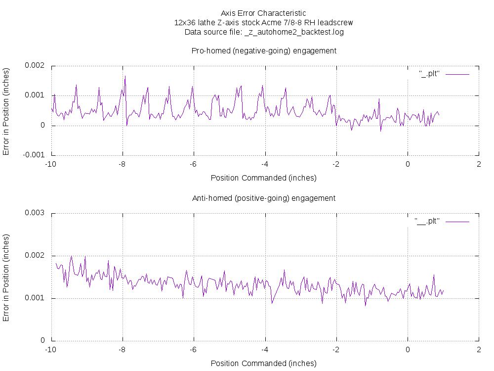

And the backtested compensation performance:
The backtest plot shows an offset of no consequence; what matters is that the curve maintains an unvarying mean response to commanded position, and the magnitude of random deviations from that unvarying mean. Moving in the opposite direction, though, results in compensated moves that are slightly off. This fault seems to be either in my logic, or LinuxCNC's logic, or possibly a faulty assumption or interaction.
I know the characterization data is accurate, because I backtest it in a separate G-code program that logs errors with my compensation data applied by the G-code values, and no compensation in LinuxCNC. The characterization and backtesting are run with LinuxCNC compensation disabled.
This all works grandly when LinuxCNC is given the compensation characteristic, when moving in the same direction as the LinuxCNC homing approach moved. Moving in the opposite direction, though, is not. I have not been able to find the source of this unexpected behavior.
What I suspect is that LinuxCNC should not be applying compensation during the homing process, but it is. The compensation characteristic is necessarily known from uncompensated configuration, based on an uncompensated home location. If LinuxCNC applies compensation during homing, then that defeats all the predicates of the measurements.
Inspecting the source code from control.c it appears that this is the case. The compensation is loaded before the homing action, and the compensation is applied to all motion from the startup. Thus the homing location is always relatively off from its true physical reference by any non-zero compensation function provided in COMP_FILE at the home coordinate. That would seem to be a logical error in the compensated motion logic. Instead LinuxCNC should disable compensation during homing. As a workaround, I suppose one could rework the COMP_FILE error characteristic function to be zero error at the physical home, but that's a whopping lot of algebra.

did you also check the switch hystereses
it may trigger not the same point

That's an interesting observation, and might warrant raising as an issue in the issue tracker:
github.com/LinuxCNC/linuxcnc/issues
