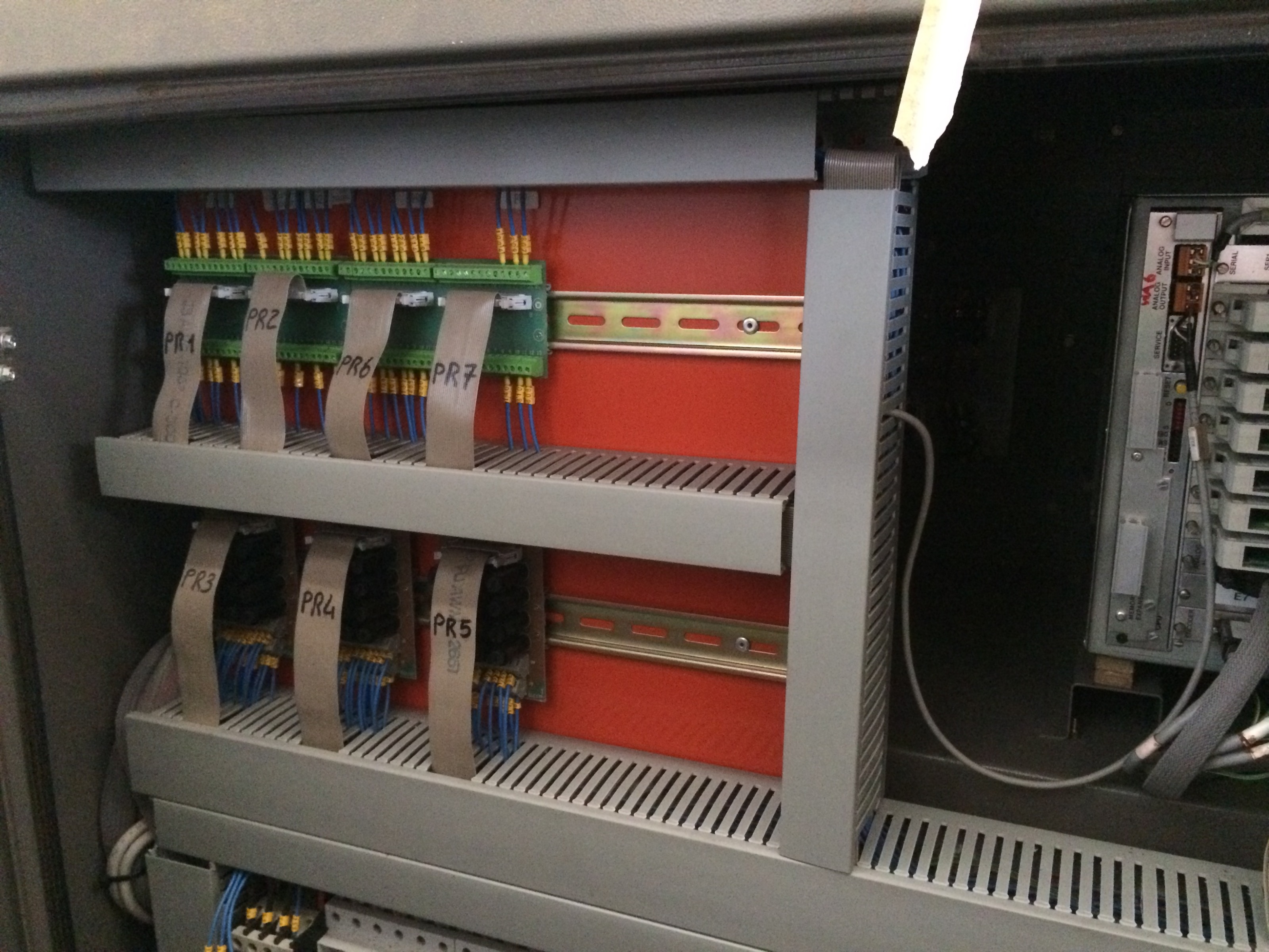

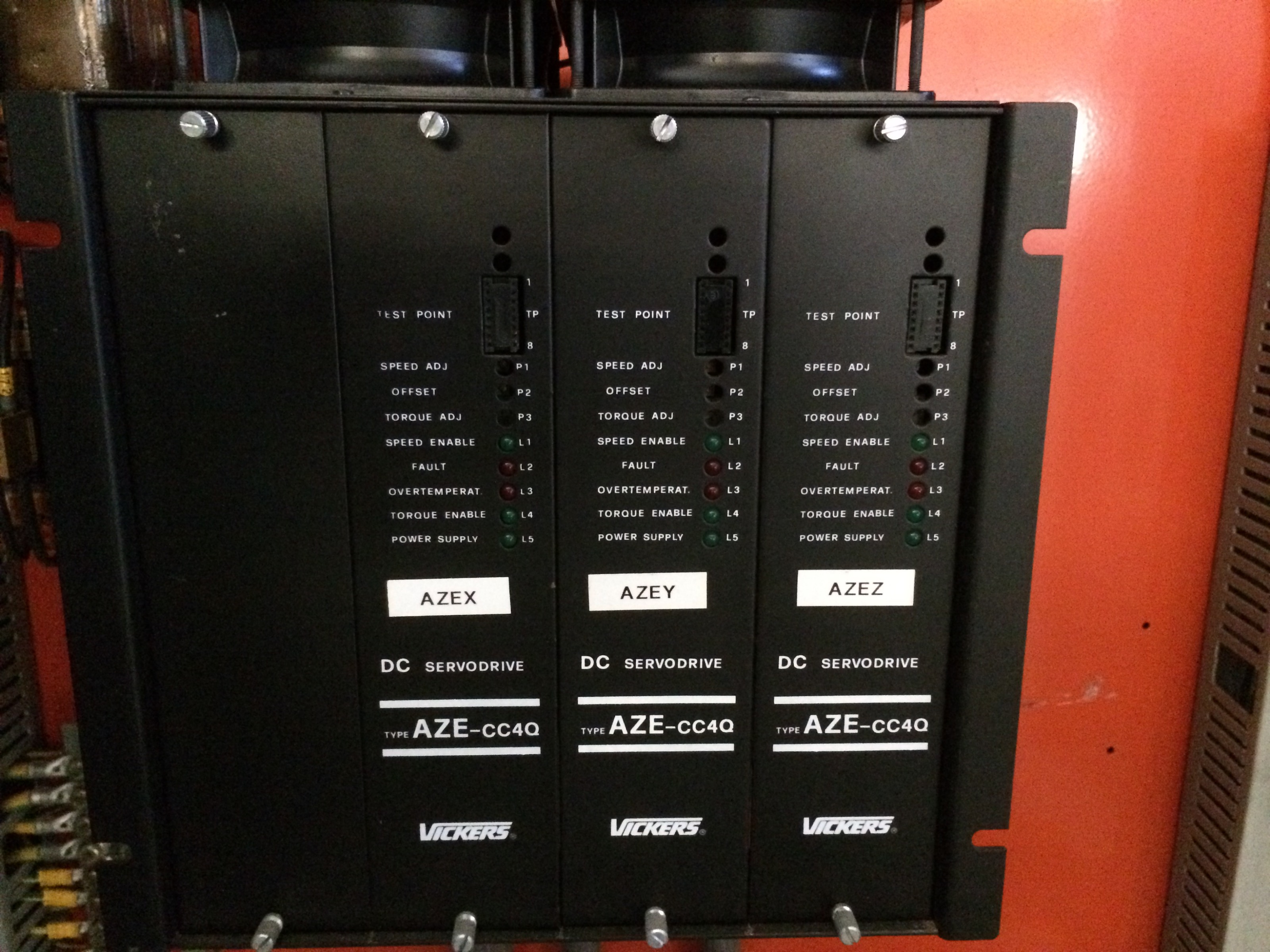

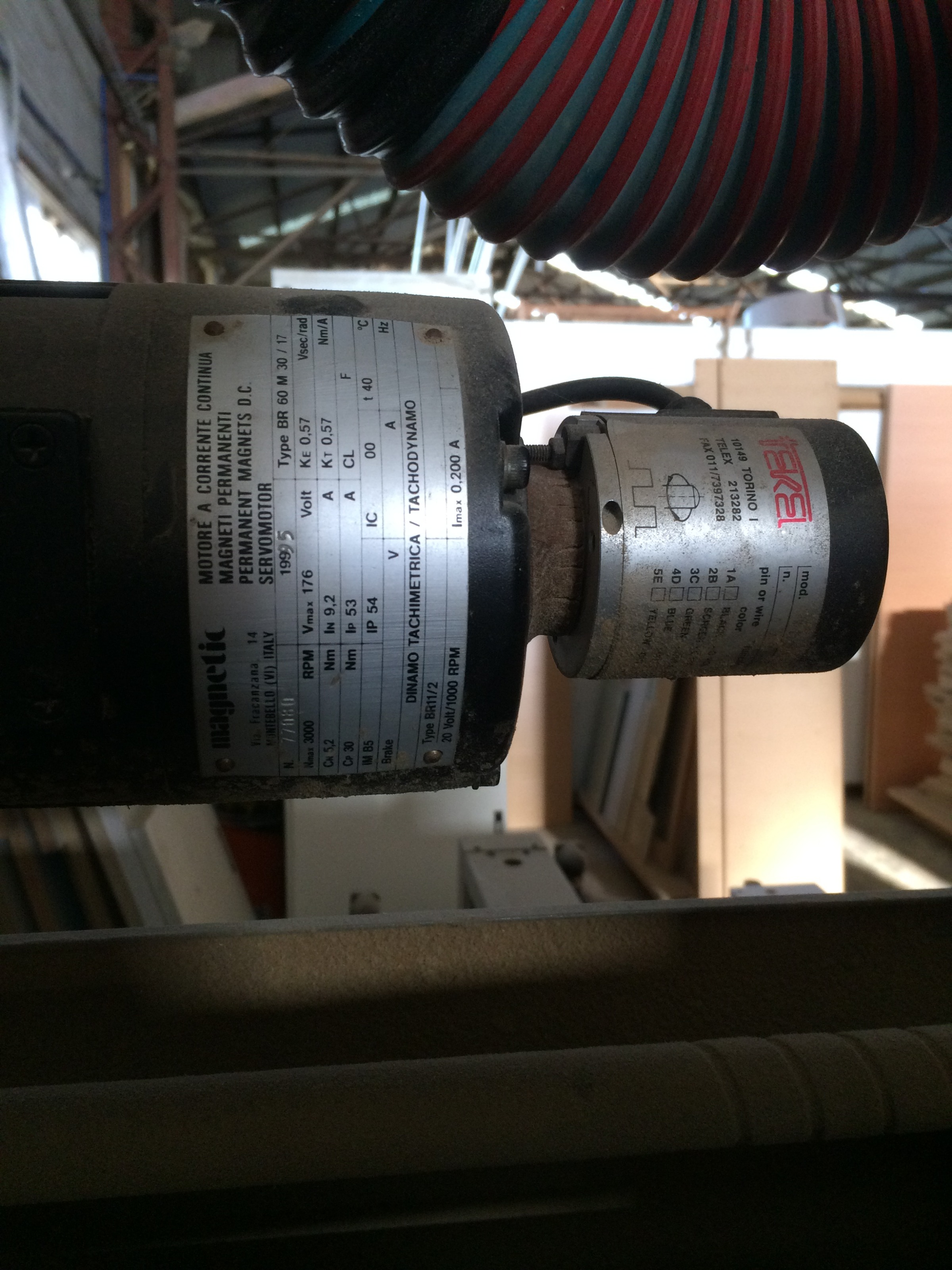

I'm considering retrofitting an old Morbidelli Author 502 we have sitting in the workshop. The computer controller died a couple of years ago and I started reading up about retrofits back then and was put off when I saw on a forum that it can be quite complicated to get the machine working with the multitool head and horizontal boring etc.
I was originally looking at Mach 3 for the OS also, however have since discovered LinuxCNC and the compatiblity with the MESA cards. I have no idea which setup would be best for this machine. I do know there are 7 parallel cards attached to the controller.
I've attached some pics of the servos and the drives.

Replied by tommylight on topic Morbidelli Author 502 - retrofit
Mach3 can not control such machines without way to many other electronics and added PLC, and even then Mach3 will never know what is going on with the machine and at what ............... never mind to long.
Linuxcnc can do that easily with Mesa cards, and it looks like you can use existing drives and motors.
Have a look at Mesa 5i25 or 6i25 ( same thing but one is for PCI slot, the other for PCI-E ) and a 7i77, maybe adding another 7i84 for more I/O.
