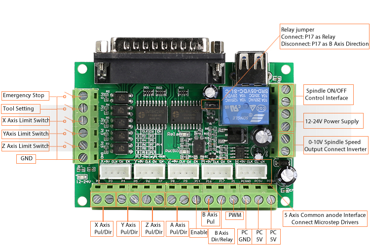

Replied by clmnt on topic AC Servo
Sorry for those few days of absence: /
This map (attached photo) has a 0-10v output. It should work.
I read that you had to connect a 12-24v power supply to pins 9 and 10.
I wonder how it works for reversing direction of rotation? -10v-0v and 0v + 10v?
How to do with a card that is only 0-10v?
Thank you

The 0 to 10V output on that card is intended for spindle VFD speed control
Its likely way too slow for servo use.
Some servo drives will accept a unipolar 0 to 10V signal plus a direction signal, but this is always problematic due to the lack of identical timing between the analog and direction signals.
If you wish to use a parallel port and this breakout board to interface to your drives, they will need to be run in step/direction mode
Edit:
If the servo is just for the spindle you could use either analog +dir or step/dir
(as long as you do not intend to use the drive as a real servo for spindle orient etc)
I suspect step/dir will be easier to setup

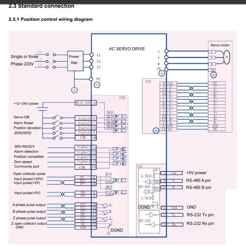

Now it's how to connect everything and configure it.(link of manual www.machsupport.com/forum/index.php?acti...33543.0;attach=44811)
Sorry if I ask stupid questions or already asked but I prefer to be sure
I enclose a screenshot of the manual on the login page in step / dir (I think)
I have to plug it in as a stepper motor?
PV? PP = Step? and PD = Dir?
I guess the 12-24v must also be connected to the servo driver?
Thank you for your precious help

Ok thank you I start to see a little clearer.

Besides, it is possible to use step / dir in speed mode?
- Posts: 19896
- Thank you received: 4648
26 Feb 2019 23:04 #127212
Yes, LinuxCNC supports velocity-mode step-geneation, ie the number passed is a step frequency not a position command.
Replied by andypugh on topic AC Servo
