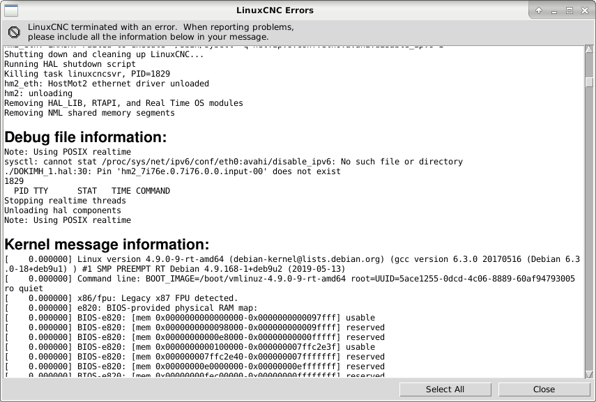

I create 2 configurations
In the first one i only configure the x,y,z, and is opening
in the second one i try to configure one input and i have this debug message
what else do ni have to do?

That error is expected if you do not have field power supplied to to the 7I76Es isolated field I/O section ( orange connector )

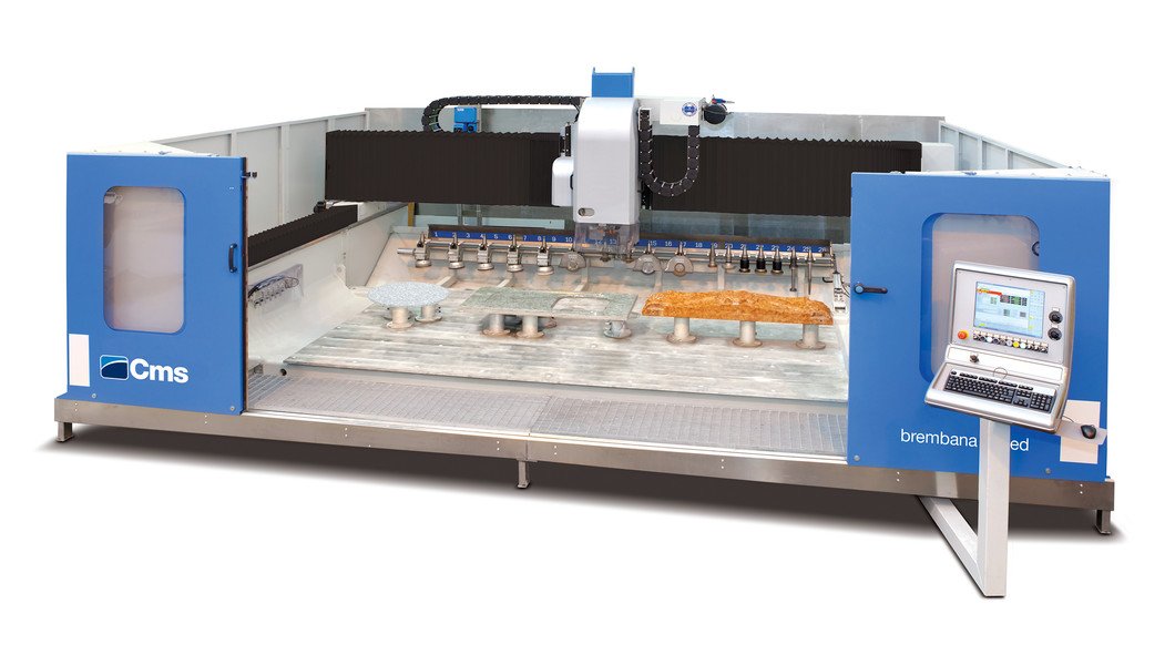

This is a photo of the machine from the net
what other info do you need?

Replied by andypugh on topic CMS MAXIMA 4 axis Machine retrofit
Right, so a rack tool changer which can be done entirely as a remapped G-code.
There is a sample config you can run, start LinuxCNC and choose:
sim->axis->remap->rack tool change
(You can run this on your live system or another PC, it doesn't try to move hardware and doesn't need hardware to run)
It needs a couple of lines in the INI file to specify the G-code subroutine to use when M6 is called:
github.com/LinuxCNC/linuxcnc/blob/master...cktoolchange.ini#L58
And then a G-code routine to calculate the correct position to move to based on the tool number:
github.com/LinuxCNC/linuxcnc/blob/master...ines/rack_change.ngc
The important part here is the use of M64 and M65 G-codes to set the values of the HAL pins that operate solenoids and brakes etc.
The main routine calls a sub-routine, you can find all the files here:
github.com/LinuxCNC/linuxcnc/tree/master...emap/rack-toolchange
