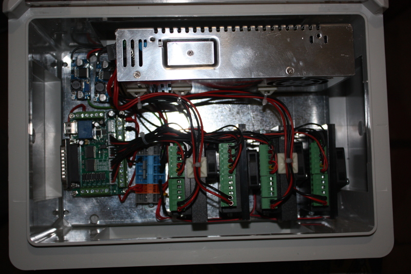

Maybe I'm searching the wrong terminology but are there blocks for linking all the ground for inputs , so you can run a single wire to the breakout board?

I like using din rail terminal blocks for the wiring or you can do crimp screw terminals etc.

I used one of these for both th +24V rail and the -24v rail but will be the wrong country for you no doubt.
www.jaycar.com.au/16-way-100a-brass-distribution-bar/p/SZ2004
Search for bus bar.
Search for bus bar.

Thanks, I know what I'm looking for now and see some that are available here

There are commoning strips for DIN rail terminals.
photos.app.goo.gl/zTbkjRHgE4PekPSZ8
The top 6 are bussed together for 0V, then two for 12V and the next 6 for 24V.
The strips fit in the middle slot and then screw to the internal metal conductors.
Unfortunately the commoning strips are specific to each brand of terminal block, and are hard to find in the catalogues as nobody seems to have decided what to call them.
www.cef.co.uk/catalogue/categories/din-r...terminal-jumper-bars
My terminals in the picture above use the many-screws type.
There are also specific commoning blocks:
uk.rs-online.com/web/c/connectors/termin...ls/commoning-blocks/

Actually, "din jumper" works on the RS web site too:
uk.rs-online.com/web/c/?sra=oss&r=t&searchTerm=din+jumper

O ordered one of these, it's got the terminals jumpers ends and rail section.
www.amazon.com/Erayco-Terminal-Press-Fit...8&pd_rd_i=B07KRDJCYB
