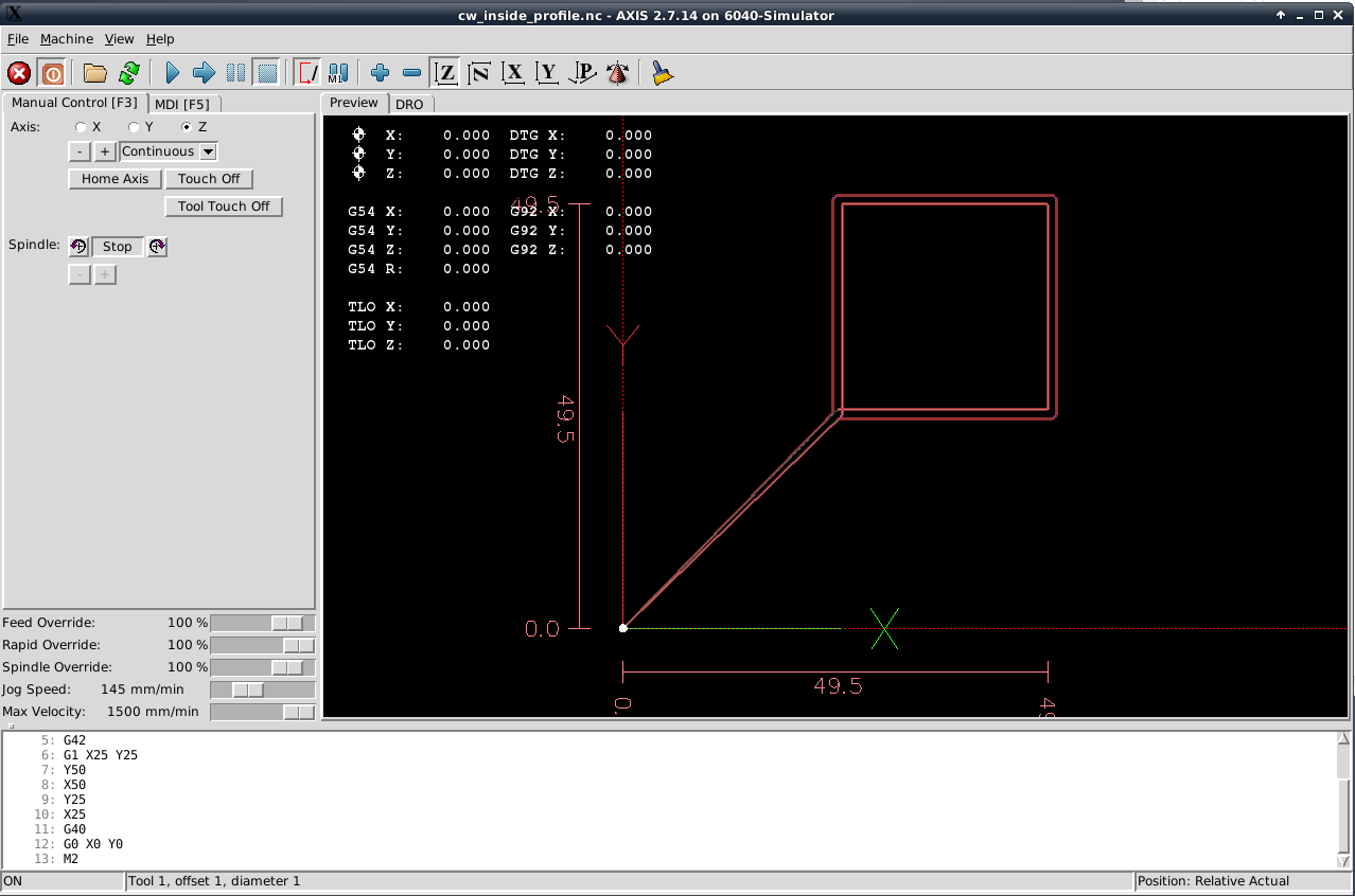

Hi guys,
I am a complete newbie on CNC and programming although familiar with (manual) machining principles and highly capable with electronics and software development. I am just getting to the point where I want to make some first cuts using my machine. For starters to validate movement, I want to cut on the outside of the path for a square path and make sure it's as expected.
I see that LinuxCNC supports toolpath compensation for either the outside or inside of the path. Presumably I could set G41 to cut on the outside and also set G42 and create a pocket.
Is it correct to use toolpath compensation for what I am asking? Or is there some other way? At present I am writing this simple CNC program by hand so I don't have the benefit of CAM tools to process this for me (part of my learning curve - start simple and build from there).
I have read: [linuxcnc.org/docs/2.6/html/gcode/tool_co...:cutter-compensation] and understand the principles but not sure it's applicable to what I'm asking.
Thanks for your patience.
Scott

Normally I use g41 for climb milling and g42 for conventional
So depending how you plan the cut you can use either

Yes, G41 and G42 are the codes. But is isn't "inside" and "outside" but "left of path" and "right of path"
