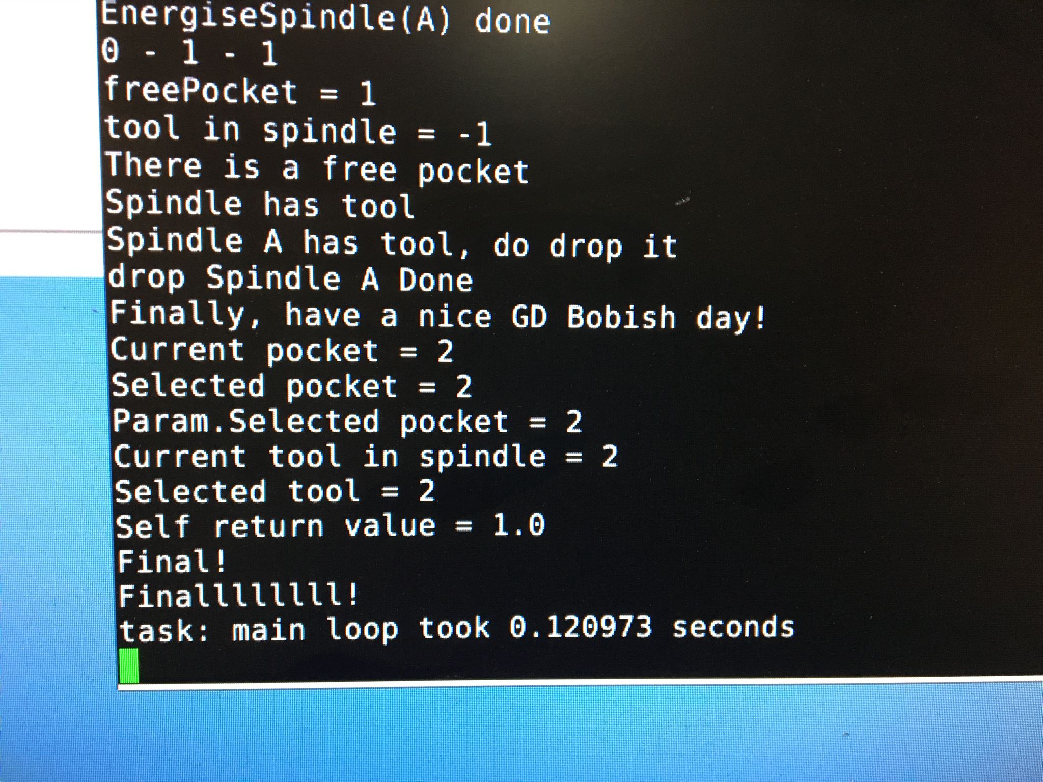

In a pure python remap in master, when the command emccannon.TOOL_CHANGE gets sent in the epilog to task, task is suppose to send and EMC_TOOL_LOAD message to iocontrol and wait for iocontrol to assert tool-change pin. iocontrol never asserts the tool-change pin.
Since the tool-change pin and tool-changed pin never gets asserted, I can never apply the offsets because the tool number never gets set. the tool change happens, and I send G43 but it does not get set on the selected tool.
I am having a hard time trying to track down why iocontrol is not asserting the change-tool pin.
Any ideas?

Anyone having issues with this?

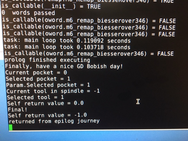

Remap pure python is broken again. The interpreter is ignoring emccannon commands.
I have nothing in the remap, no Q-busters nothing, and it wont run the epilog.
ini entry:
M6 Remap:
This is showing that meets the if criteria for epilog

I also tried a bare bones remap with no queuebuster and it still doesn't send the emccanon.CHANGE_TOOL nor the
self.set_tool_parameters() or self.toolchange_flag = True.
EDIT: I am basing the fact that the interpreter is ignoring the command because when I send emccannon.CHANGE_TOOL, task is suppose to send an NML message to iocontrol and iocontrol.o.tool.change get set to true. thats not happening also when I send tool-change_flag = true, that should tell iocontrol and iocontrol.0.tool.changed happens, which is suppose to send message back and then the offsets get set depending on the selected pocket. emccannon.CHANGE_TOOL gets sent with "selected_pocket" parameter.
None of this is happening, I dont know wether I should loop the iocontrol or not in this case. /EDIT
So I think something is broken.
If I yield throughout the toolchange, then the interpreter starts ignoring commands and things get haywire.

You need to trigger this code here:
github.com/LinuxCNC/linuxcnc/blob/master...sk/ioControl.cc#L825
And it looks like CHANGE_TOOL should do that:
github.com/LinuxCNC/linuxcnc/blob/master...sk/emccanon.cc#L1984
As it does create a EMC_TOOL_LOAD_TYPE
There is a rtapi_print_msg(RTAPI_MSG_DBG in the iocontrol code, it would be useful to know if the code is being called. Unforunately the messageing level here is _not_ set from the INI file. You might even need a HAL component to call linuxcnc.org/docs/2.7/html/man/man3/rtap...sg_level.3rtapi.html
