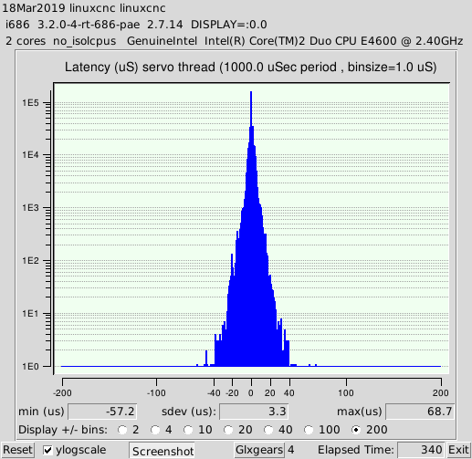

Replied by PCW on topic Linuxcnc floods me with errors..
Can you post a small portion of your ping responses?
Do you have a Intel MAC on the PC?
(might have to look through dmesg to find out)

Does not sound good
Also the ping times are quite slow (about double mine on a (faster = 3,16_ GHz) Core Duo
Might possibly just be something wrong the the PC
You might try running the servo thread slower as a test, say 2000000 ns = 500 Hz
Hmm,
[ 3117.364020] [drm:i915_hangcheck_ring_idle] *ERROR* Hangcheck timer elapsed... render ring idle [waiting on 1692055, at 1692055], missed IRQ?
Does not sound good

I will change the pc soon, maybe tomorrow, I got a minipc i7, 4gb ram, ssd. It will run debian stretch preempt rt kernel.
A linux guru friend of mine has managed to obtain latency of less than 10000ns.
Hope the network card of that one is better.
