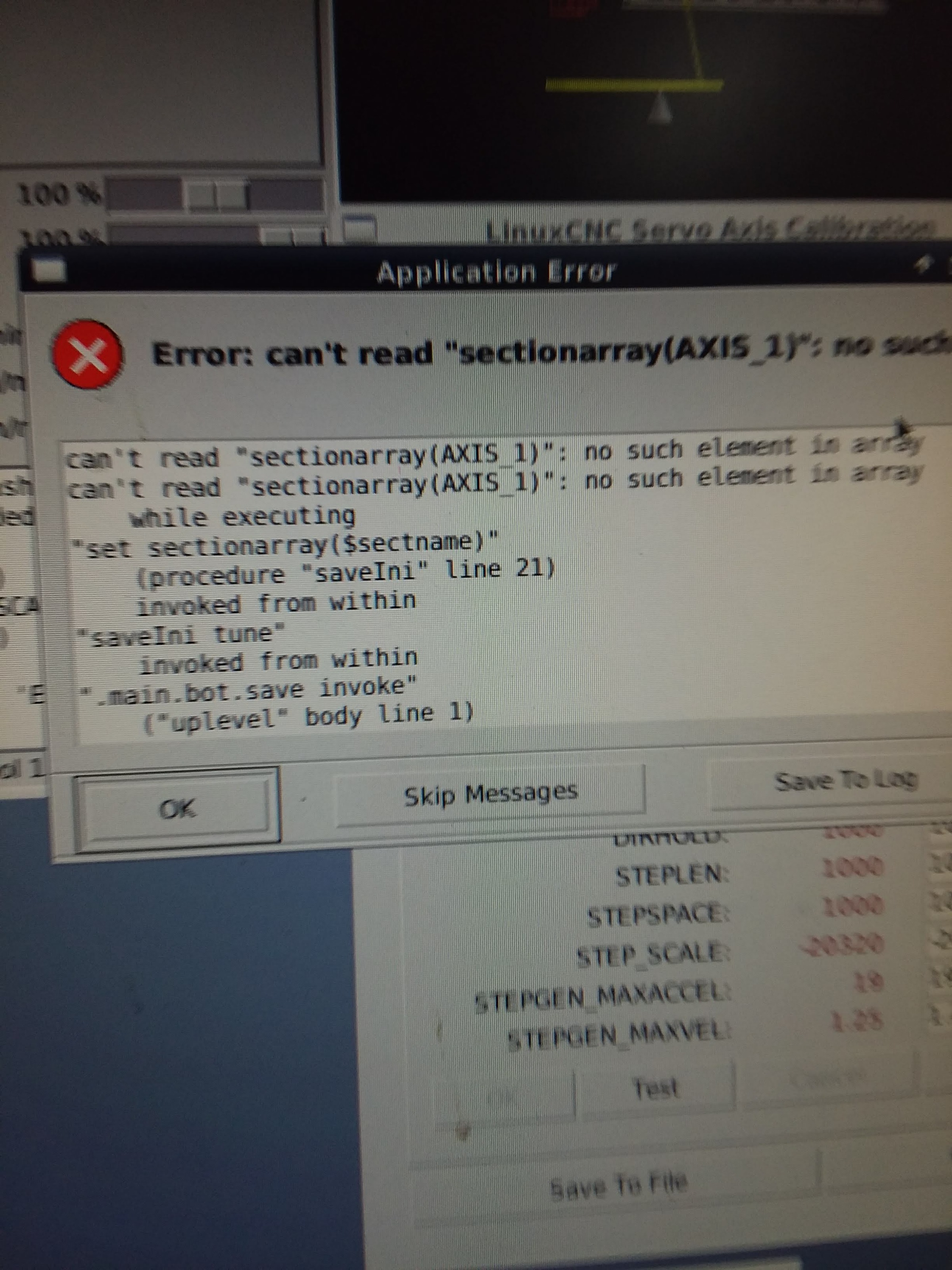

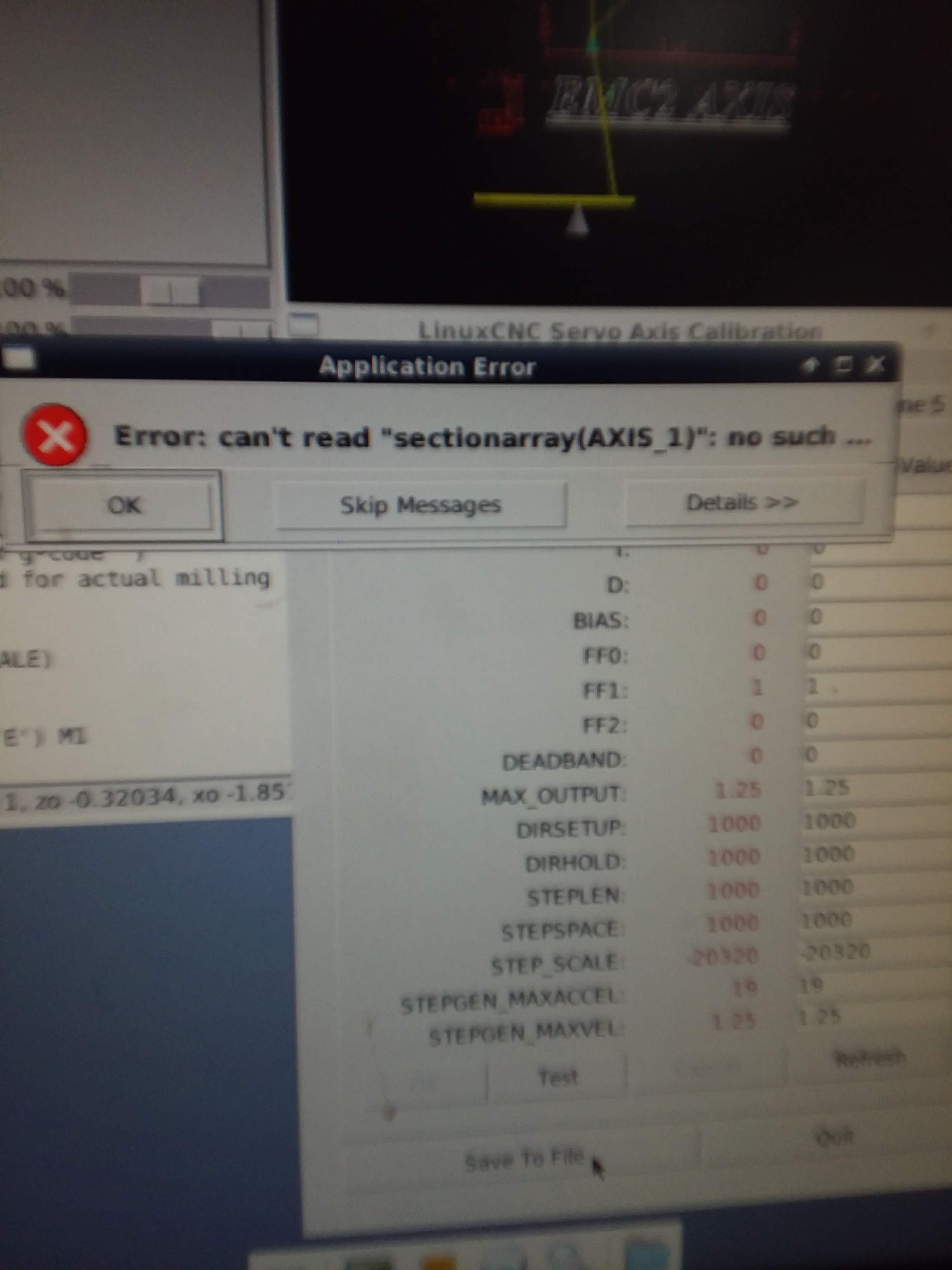

I have changed the scale to -20320 and lowered the acceleration from 37.5 to 19 and this helped my issue. It is still off about .007" over an inch and changes a small amount every .100" step I take. In the video you will notice after every move it over shoots a small amount and comes back sometimes to where it should be, alot of the times it's .001" off per move. In this video it comes back to 0, but most of the time it's off .001". Running a long program it will shift the zero over .100" by the time it is done. The faster the machine moves the more pronounced the issue. When the accleration is lowered, the issue is more pronounced at lower jog speeds as well.
Short example of the issue I am having . Notice the over shoot and return.
The last issue I am having is I can not save the calibration page. When I make the change to -20320, when I close emc2 it will reset back to the original problematic numbers. Thanks in advance.

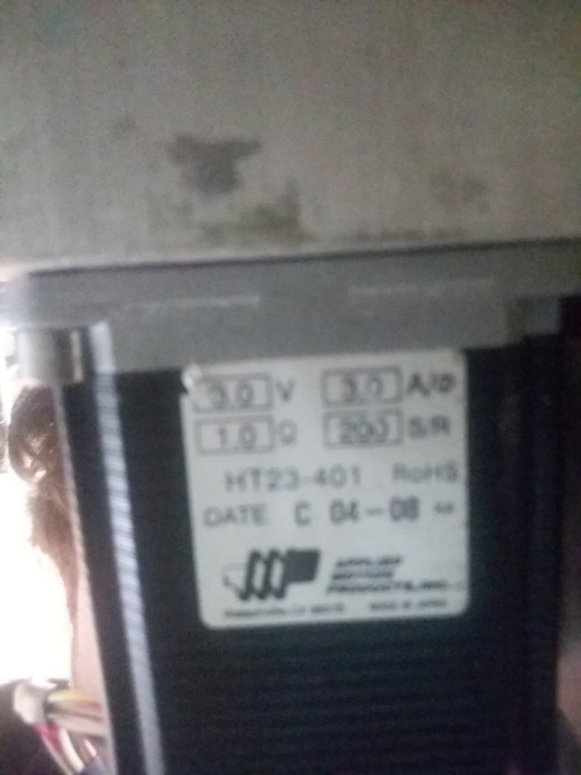

- Roland2161
- Posts: 36
24 Mar 2019 18:59 #129538
by Roland2161
Replied by Roland2161 on topic Servo Tuning
This is the stepper motor, bad picture but its 200 sr 3v
www.ebay.com/i/113693882984?chn=ps
The motor is directly connected to the ball screw.

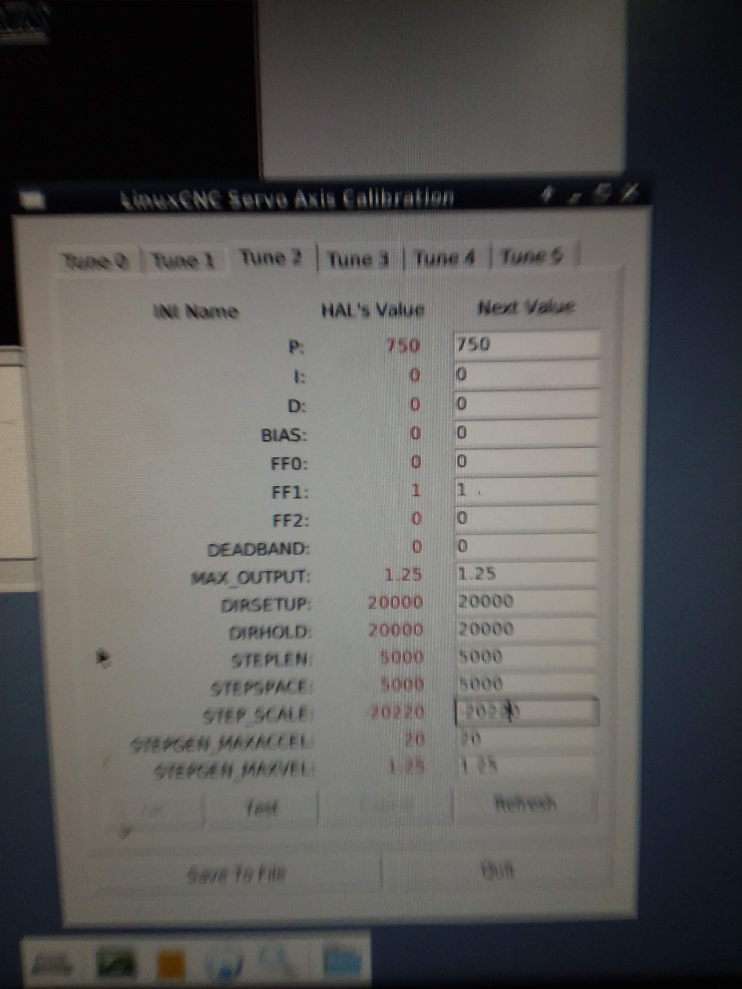

24 Mar 2019 20:31 #129548
by Roland2161
So this is where I'm at currently.
-20220 is what this is set to currently and it's close. Maybe some backlash compensation? How would I insert that into the .ini file?
