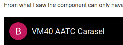

On to next project. ATC carasel type.
Can I use the carasel component for this machine? It has 21 pockets. IT has a weird encoder that gives pulses for each pocket. I put an index on it at pocket 1.
From what I saw the component can only have 8 pockets?
