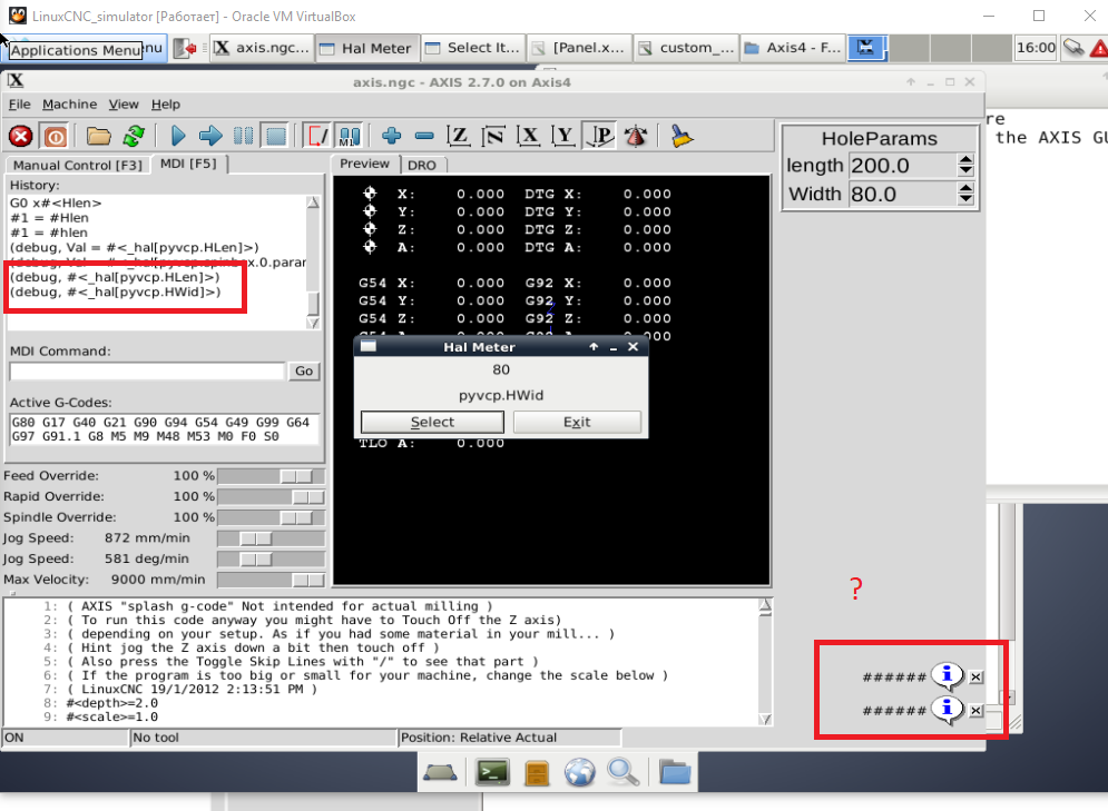

Hi, all.
I make pyvcp panel, where I can write some variables, correspondly to topic SPINBOX DATA to G-Code VariableSPINBOX DATA to G-Code Variable
Now, when I try to get value of the pin (debug, #_hal[<pyvcp.Hlen>]) , I get ####.
But If I write directly to (debug, #_hal[<pyvcp.spinbox.0.pin_param>]). Everything OK.
Why it so?
My aim is to set values from pyvcp xml panel and to run it in g-code.It's hard to debug g-code, if I will use values "spinbox.0.pin_param", etc.
Why it so?

Have you read this?
linuxcnc.org/docs/devel/html/remap/remap...ap:referto-hal-items
I know it is in an obscure location, also look at the preceding sections for related info and cautions. I use this in my Gcode files all the time to get operational parameters from my GUI.

Thanks a lot, it's working.
Proble was in upper case letters. HAL command works only with lower case letters.
