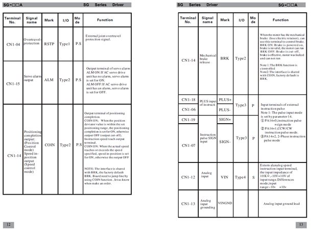

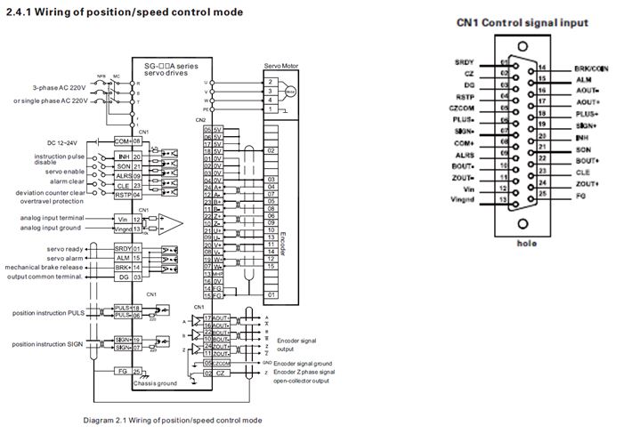

Before I connect the Z, I would like confirmation that I am connecting it correctly. Attached snips take from “SERVOMOTOR 2KW SERVODRIVE SG-30A 2_4KW DATASHEET”
On the CN1 25 pin plug. Do I use 18 = step and 17 = Dir. Do I connect both pins 6 and 7 into common GND.

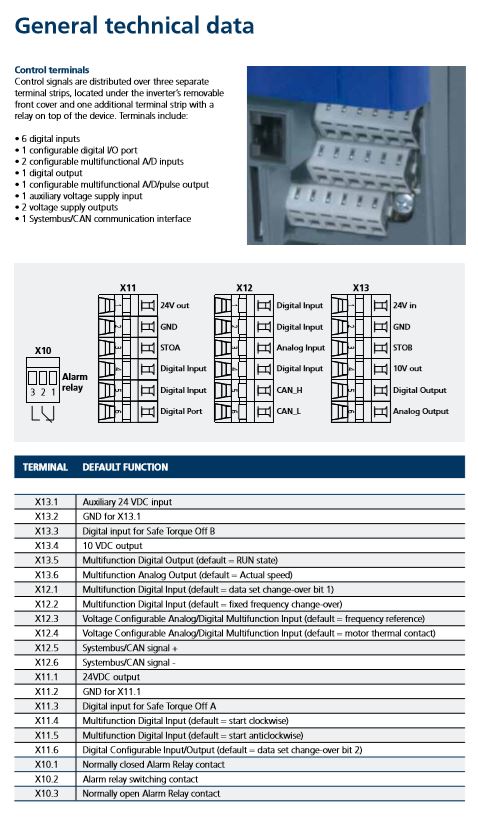

How do I connect the Spindle drive? “ Bonfiglioli Vectron Frequency Inverter AGL202-i8 2 FA”
Is the PWM pin used for this? And what else? Attached is page from catalogue.
www.bonfiglioli.com/international/useful..._agile_eng_r01_0.pdf

For the servo connection the answer is yes, although it is a bit blurry so not 100% sure.
VFD will need some programming before connecting to anything, first you have to decide how you want to control it, voltage or step/dir. Both types work, but i prefer voltage whenever there is encoder feedback.

There is no encoder on the spindle motor. I understand it is 3 phase. Just a 4 wire connection plug. Have it in bits at the moment for bearing replacement.
