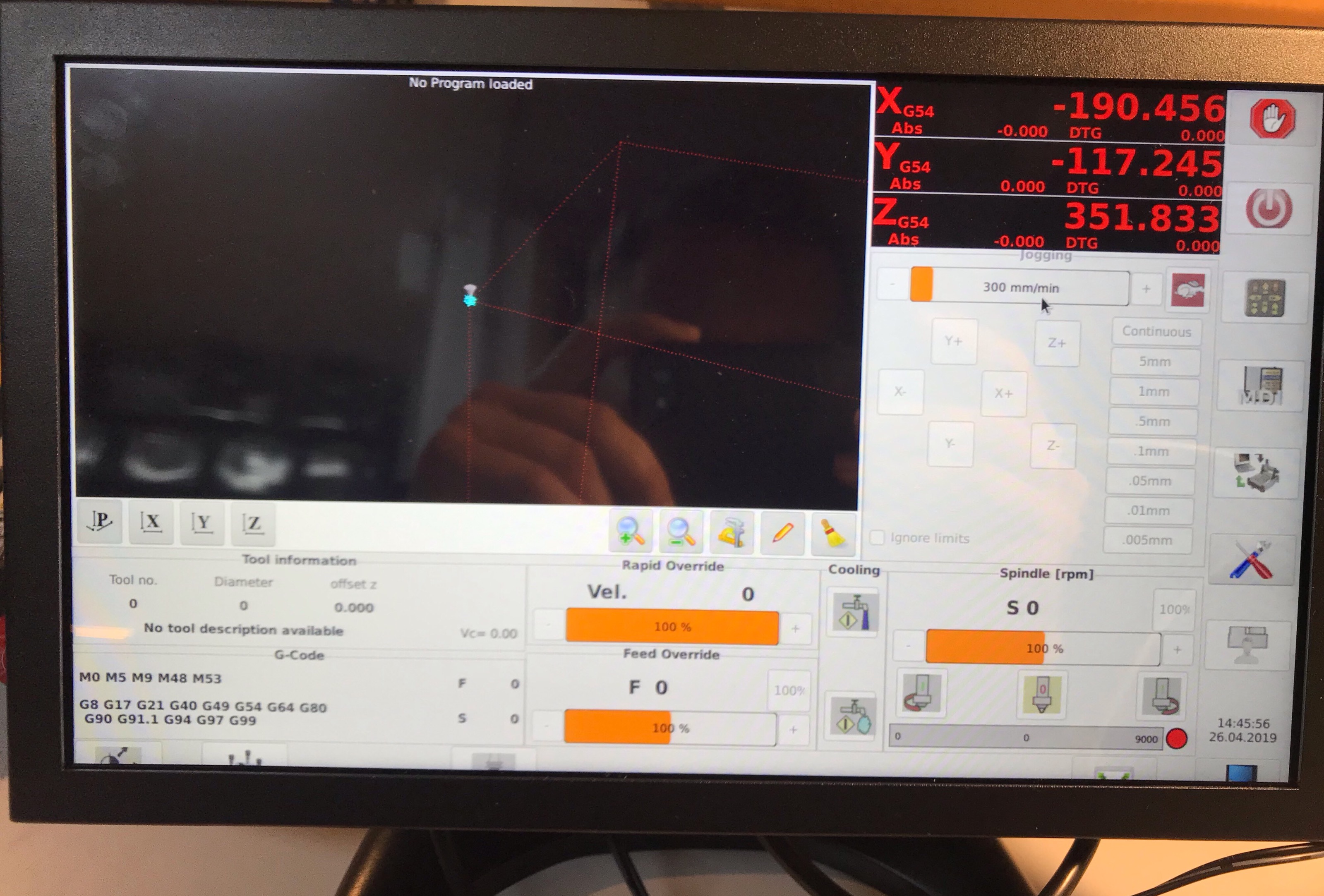

Hi guys,
Just bought a touch screen for my linuxcnc controller. The screen size is a bit too small to run it in full hd, the buttons are too small.
So if I run it in 1280x720, the buttons are touchable, but gmoccapy is cut on the bottom side.
Is there a way to make gmoccapy smaller from some config files?
Here is how it looks

Replied by Todd Zuercher on topic Gmoccapy is cropped on 1280x720 resolution.
My personal opinion is that most of the newer gui's being developed for Linuxcnc are requiring far too high resolution and screen size for a machine control. They should be capable of running satisfactorily on at least a 800x600 screen (preferably 640x480). Is it really so hard to make these scalable?
