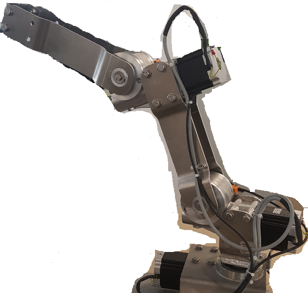

i built a robot arm with three axes. See Picture.

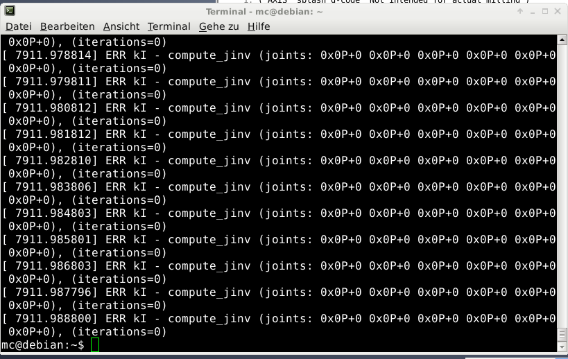

I control it with the Mesacards 6i25+7i76. I tried the vismach config with genserkins. All three axes alone drive very well but if i try the world mode nothing happens. I homed the axes but nothing happens.
If i try the command "dmesg" in a terminal the following error is be shown. What this means?

THE error complaqins on Joints
the HAL includes AXIS there is a MISSMTch on Version of Kins
Please tell us what verison and operation system you using Wheezy Ubuntu debian
2.7.x or 2.8.x
this Combination of files is not working
use the puma560 and it will work in world mode
2.7.x or 2.8.x

- Posts: 18117
- Thank you received: 5335
16 May 2019 13:58 #133972
Replied by PCW on topic Robot Arm not move in World mode
1. You would need LinuxCNC 2.8 to have joint.0.motor-pos-cmd
2. If that "Error: Joint.0.motor-pos-cmd" is the actual error, you have Joint capitalized
which would not work

Is there a possibility to Control the Robot arm with Linux cnc 2.7.14.?
- Posts: 18117
16 May 2019 14:22 #133978
Yes, but note that many of motions signal names have changed between 2.7 and 2.8
and joint.0.motor-pos-cmd is a LinuxCNC 2.8 pin name.
I do suspect that LinuxCNC 2.8 would be a better choice for robotics since it makes a clear distinction between joints and axis

i have updated to 2.8
after Homing my Axes it shows an error "KinematicsInverse failed".
I think my D-H Parameters are wrong or?
