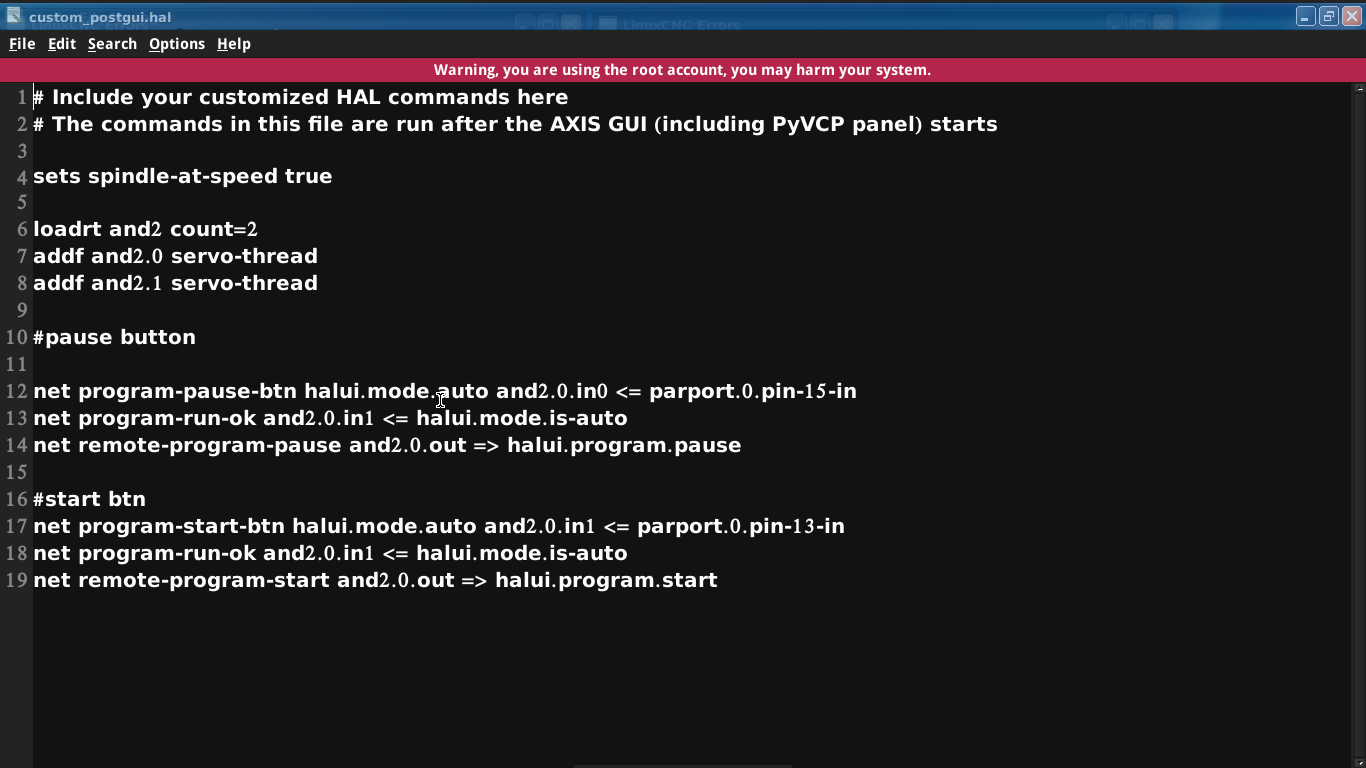

i want step by step instructions to how to add external start button in axis using hal
i specificcaly said STEP BY SYEP
on parellal port pin 15

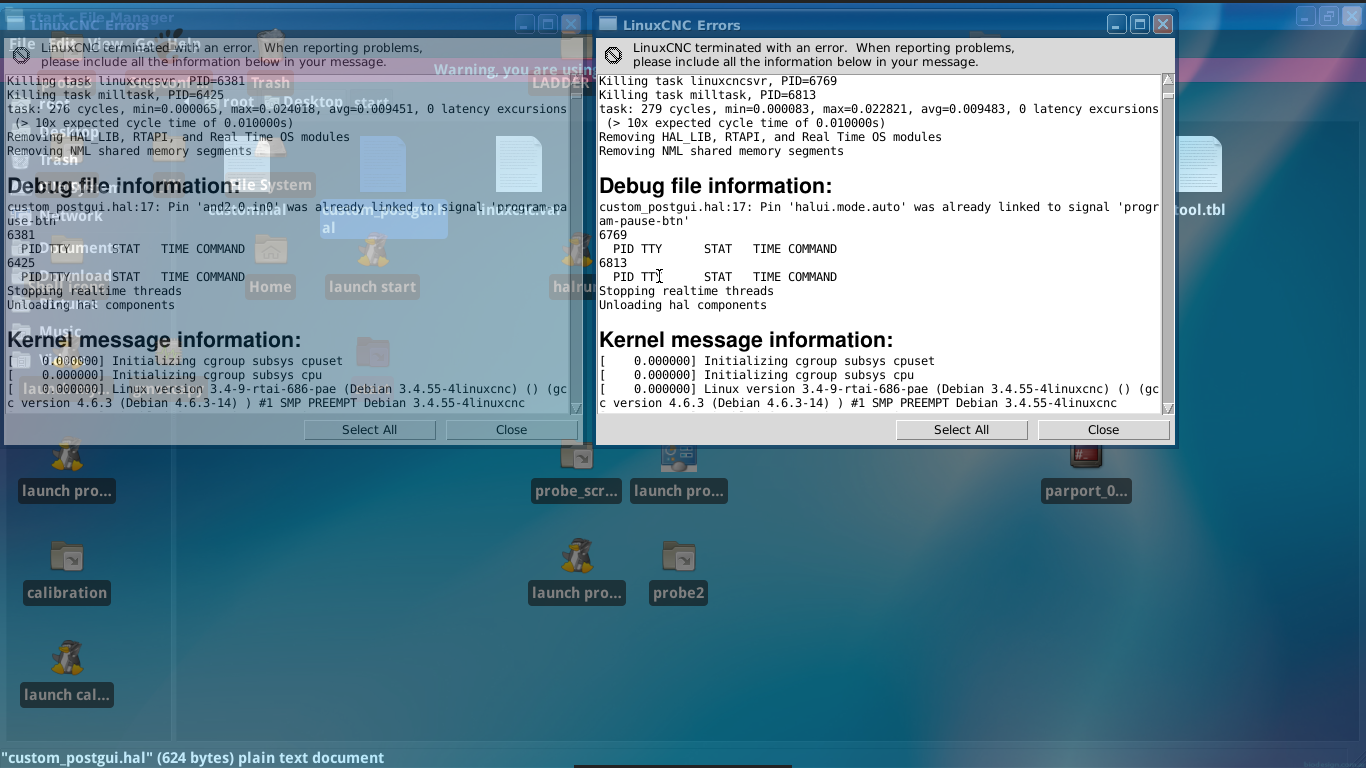

You have tried to connect halui.mode.auto to two different parallel port pins.
This isn't allowed, because it can't work. What value should halui.mode.auto be set to if the two parallel port pins have different values?
You probably need to send the parport inputs to an or2 component, and then take it from there to halui,mode.auto
Also, you are using and2.0 in both sections, and probably mean to use and2.1 in the second part.

I have a pause/resume button and a cycle start button. This is running on 2.7 for 5 years now.
On 2.8, names may have been changed to protect innocent.
# Cycle-Start
net cycle-start <= hm2_5i25.0.7i77.0.0.input-12 halui.mode.auto halui.program.run
# Pause/Resume
