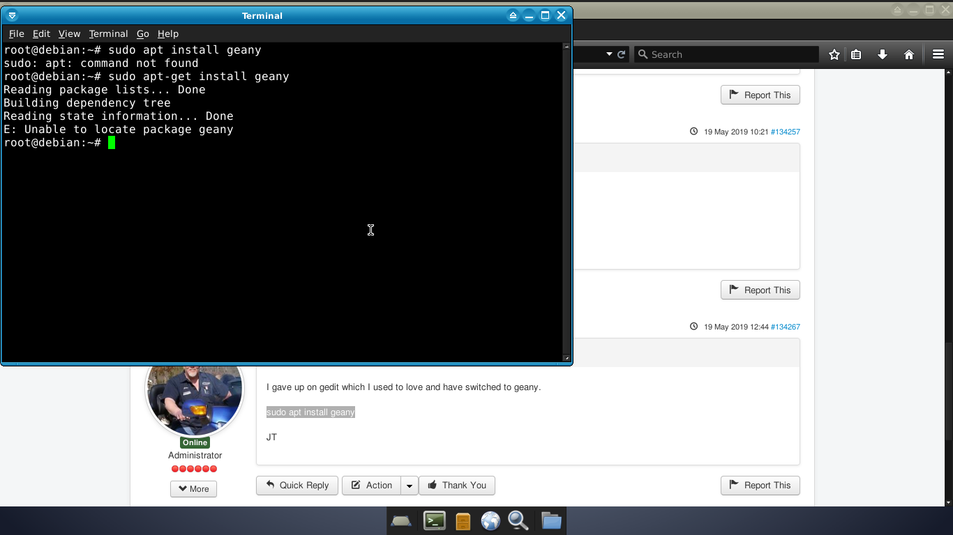

how can i install softwares in linux
do i need to add repository for each software ??
i searched on google how to install gedit
it say s apt-get install gedit
but when i tried it it says pakage not found

What version of linux are you using? Wheezy? If it's Wheezy is out of date. I think you can reset the repositories to make it work again.

Its streach after wheezy i also added official repositories but doesn't work
Any repos suggestions please???

I gave up on gedit which I used to love and have switched to geany.
sudo apt install geany
JT

Copy and paste the output is always better than a screen shot.
What OS are you using?
You may need to update with sudo apt-get update.
JT
JT

hi i wars just gussing
as of lts support stop debian wheezy
he might be better up on
vi /etc/apt/sources.list
######### change the main and updates to
deb archive.debian.org/debian/ wheezy main non-free contrib
deb-src archive.debian.org/debian/ wheezy main non-free contrib
deb archive.debian.org/debian-security/ wheezy/updates main non-free contrib
deb-src archive.debian.org/debian-security/ wheezy/updates main non-free contrib
Run
apt-get update
if you get key error
apt-get install debian-archive-keyring
... and run
apt-get update
then you can update by apt all the old software
