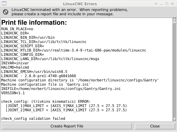

Yes, they have changed. I did a new run of stepconfig and then edited the resultant .ini and .hal files per a forum post. And the result does not run.
I will attach the current .hal. and .ini files and also part of an Axis error report and part of a resultant error report which always occurs when I click the button on the axis error report to "generate a report". When I look it the directory /tmp there are many new files and I will attach the linuxcnc.report and the linuxcnc.info.txt files.

29 May 2019 15:33 - 29 May 2019 15:35 #135278
by bevins
Replied by bevins on topic Joint limit switch errors
IF I am not mistaken it should be:
You have two [AXIS_Y] sections. I don't know if that matters but it seems like it should.
[AXIS_X]
[JOINT_0]
[AXIS_Y]
[JOINT_1]
[JOINT_2]
[AXIS_Z]
[JOINT_3]
Last edit: 29 May 2019 15:35 by bevins.

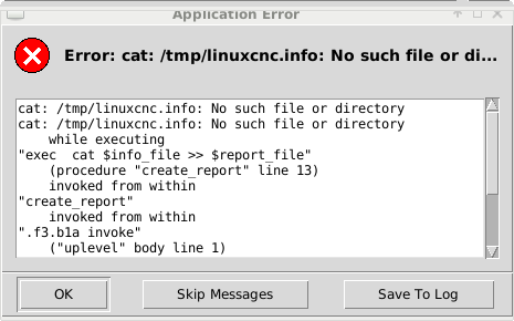

29 May 2019 15:46 - 29 May 2019 15:48 #135281
by dgarrett
Replied by dgarrett on topic Joint limit switch errors
This error:
is due to having multiple (repeated and redundant) stanzas for
[AXIS_Y]
(There may be other errors after fixing this)
This reporting error:is a bug addressed by new commit: d3956a3bf
github.com/LinuxCNC/linuxcnc/commit/d395...ba0614388462d0d199cf

29 May 2019 17:51 #135309
by norbertfarquharsh
Replied by norbertfarquharsh on topic Joint limit switch errors
Thank you very much.
Once you said what you did it made sense and I corrected it and that problem was fixed. But I never would have spotted it. I just copied and pasted the whole joint block and edited some of the values but did not edit out the duplicate axis info. Can't thank you enough.
