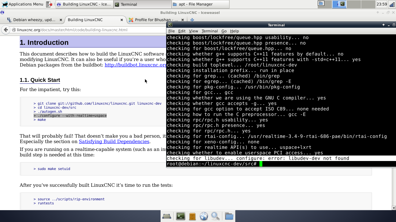

sir ,
my problem is i dont know how to compile github pakages 'i tried it earlier while satisfying and installing build deps ... it sauddenly say pakage is available from another source
and i can find that source repo
THanks for Your Support

- Posts: 19902
28 May 2019 22:33 #135210
Replied by andypugh on topic Building linux cnc from github
It may be that you need to install (a lot) of dependencies.
Try these steps, then you need to copy and paste the package list, then edit it a bit (to take out the bits that specify a version and when two packages are suggested with an "or".
linuxcnc.org/docs/master/html/code/build...g-Build-Dependencies
