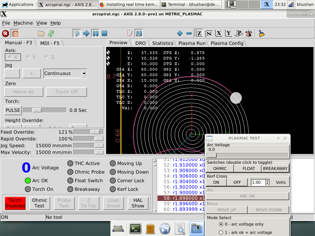

sir i have debian 9 with linuxcnc 2.7.14 and today i compiled plasmac on it how do i know which linuxcnc is starting when i type linuxcnc on terminal
cause i cant see plasmac configration
my appologies for bothering you

the key is the rip-environment as it tells where to find the files. If you get it right you will see 2.8 when it starts.

You need to give a path that leads to the linuxcnc-dev/scripts directory.
So, if you are in your home folder the command would be
And it does need to be dot - space - dot - slash
. ./linuxcnc-dev/scripts/rip-environmentAnd it does need to be dot - space - dot - slash

my apologies for being so desprate
i found plasmac conf it more than awesome sirr....
but still unable to find reverse run in axis plasmac inteface
but i must say interface is legendery for plasma
thanks again
thanks again

The plasmac sims have moved. Look under the by_machine list. I think its there.
I have not upgraded to the latest version yet. Please tell us if the enable torch button is in red and green for debugging another issue

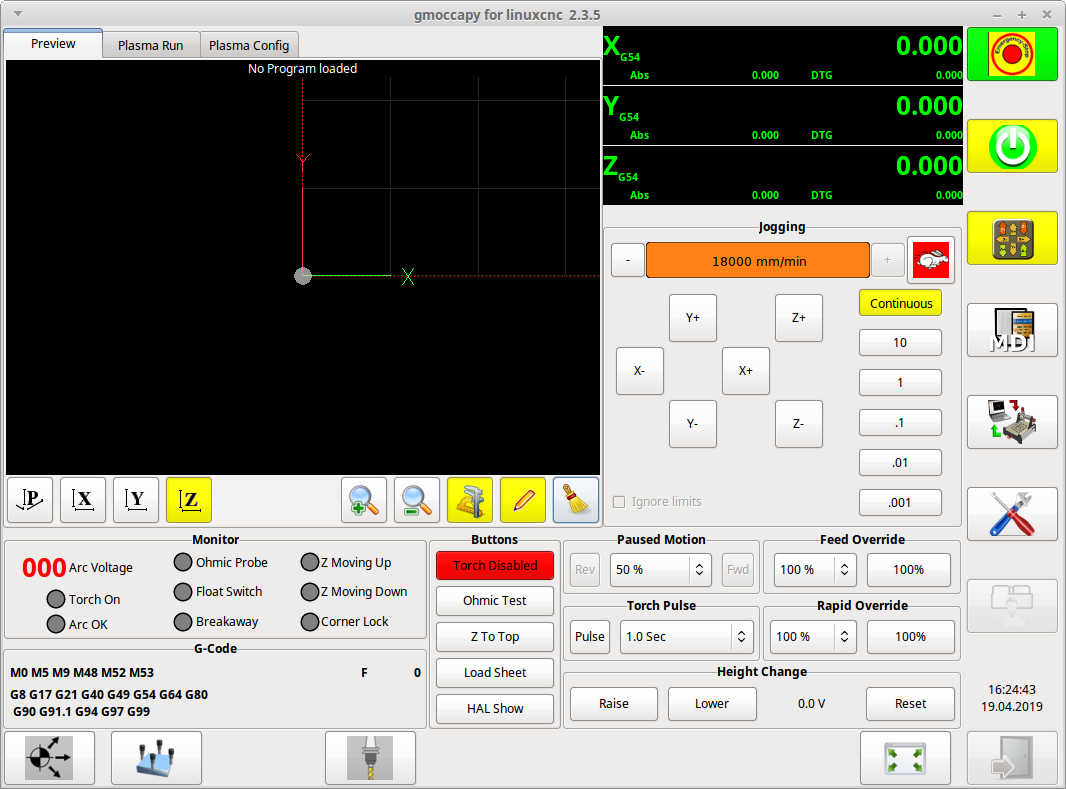

cant i reverse run in axis???

sir that buttons in axis opens when i pause the code but i think they are not working tried rev and fwd but it di=oesnt do anything

also not working in gmocccapy
pls tell me what am i doing wrong
Replied by phoenix on topic installing real time kernal
