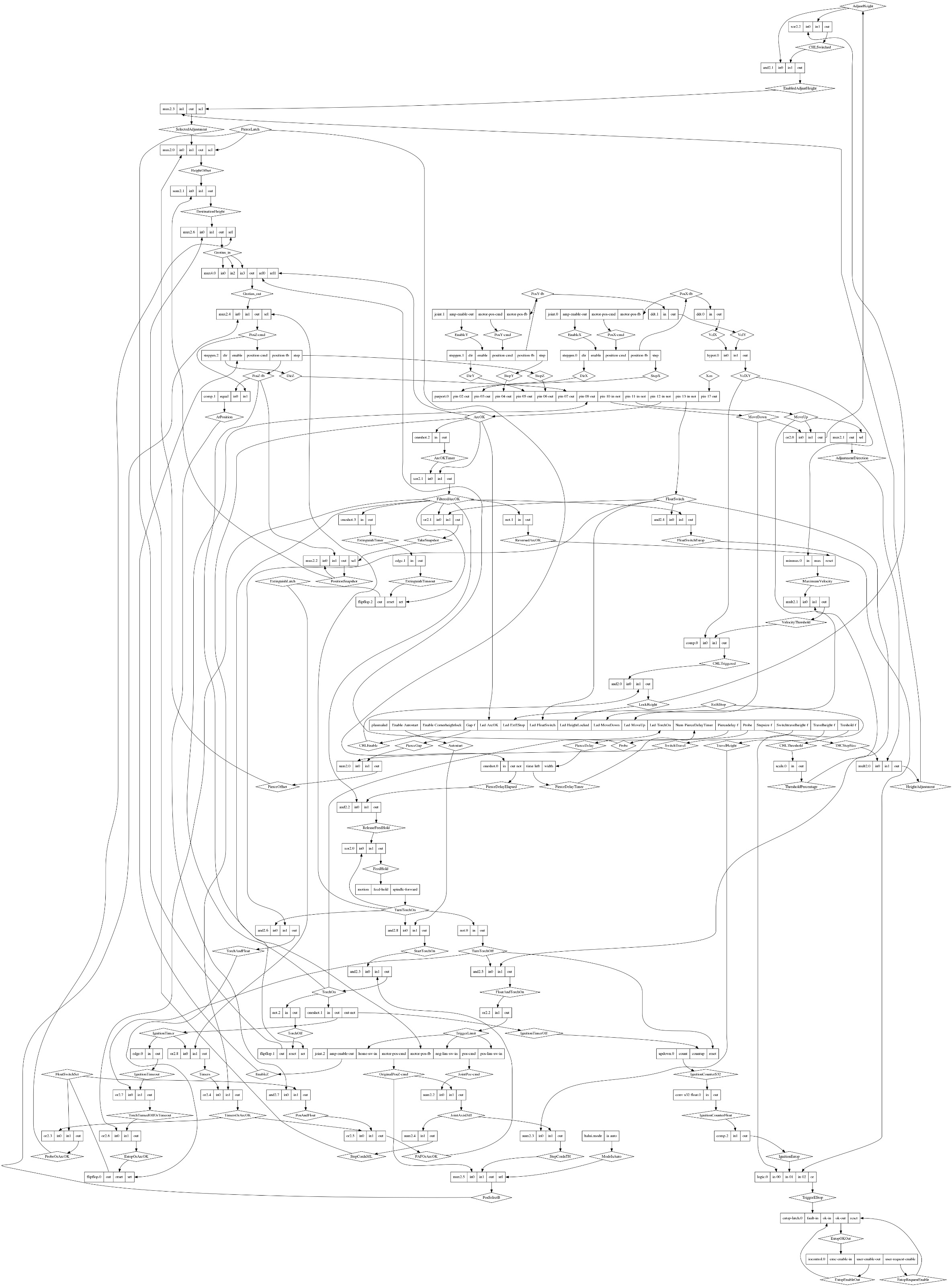

The plasmac.comp file appears to be just one big unnamed function, with most of the logic in one big switch statement on a machine state variable. How does the linuxcnc system call this function? I guess it has to be called from a loop somewhere. How fast is this loop called?
The plasmac.comp (c-code) goes into machine code by compiling it into plasmac.so
At this moment it can be inserted in the real time kernel. In fact it looks like the insmod function.
Linux read's at startup the ini and hal files. It load's the list file by file. So it loads the plasmac.so at the specefic hal line.
This loop is as fast as the kernel loop if you use the base thread. Servo thread is slower, but fast enough for this function my dear.
Is there a chart somewhere that illustrates the order of execution, precedence, etc.?
You can make your own chart. I have atteched source code for this to visualize.
A compile example :
sudo halcompile --compile plasmac.comp => wil give you plamsac.so in same directory (otherwise use the --install flag)
sudo halcompile --preprocess plasmac.comp => will give you plasmac.c
Whoa, I asked for a chart and I got one! So if I were to run that python script on my machine it would dynamically generate that diagram based off of how my machine is currently configured? (I'm not at my linuxcnc machine right now)
Okay, so looking at the basic hal tutorial: You use loadrt to load the component, like importing a library in c like #import <>. Then you call addf to initialize it however many times you need it, kind of like a c++ object. Right? But in the case of the plasmac it's a "singleton" so it can only be intialized once.
... I think it's starting to come together.

29 May 2019 16:46 - 29 May 2019 16:51 #135296 by Grotius
Replied by Grotius on topic How do .comp files work?
@Kyle,
It's visualizing complex environment's, just like the most complex toma.thc files in this case. B) And done some improvement's because that is not possible without this view diagram.
You can google on dot.py how to use this old stuff. It's old and almost gone from the net, but the power of this python script is nice.
Maybe post it on the Git....
In what code is "option singleton" converted into when compiled from comp to raw c?
The preprocess compiler will change this i expect into some other c code.
@Kyle, The singleton line is not important in your case at this moment. There are much more option's to use with the compiler.
