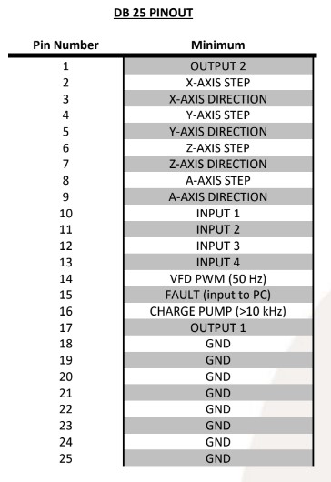

- ictponder
- Posts: 23
10 Jun 2019 21:54 - 10 Jun 2019 21:56 #136532
by ictponder
Replied by ictponder on topic Wires detached from parallel plug
Very good, that should help me understand what's going on a little better as I assumed each limit switch was isolated.
I found this image in a manual for a gecko drive a friend sent me that shows the pinout for that system and I wondered if the parallel plug is always going to be the same no matter what other than changing the axis labels? I've also got my VFD connected via USB directly to the computer, not the parallel plug. I've attached the image.
Last edit: 10 Jun 2019 21:56 by ictponder.
- Posts: 19915
- Thank you received: 4663
11 Jun 2019 06:06 - 11 Jun 2019 06:08 #136583
If it's a Gecko with a DB25 then it must be a G540?
Yes, the pinout of the G540 is entirely standard for a G540, but may not match anything else.
It might be worth knowing that there is a firmware for the 5i25 / 6i25 PCI cards for the G540 if you find that you run out of step rate with the parallel port.
You might also find that the charge-pump input can't be driven by your parport except in EPP mode (BIOS setting) and possibly not even then. The charge pump can be disabled, but obviously it would be better not to.
I now see that you were showing the Gecko pinout purely as an example. No, there is no standard for how a paralel port is wired to drives, you can do it any way that is convenient.
Replied by andypugh on topic Wires detached from parallel plug
