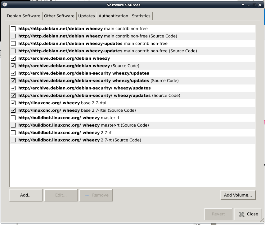

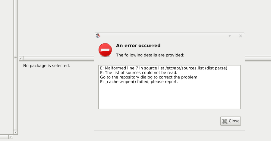

That looks correct but the error is a malformed line in /etc/apt/source.list so you need to edit it to correct the bad line.
How did you add the archive sources?
I don't see the main contrib non-free in any of your archive sources and it must be there.
Andy, posted the contents of the /etc/apt/sources file so compare your sources file to his.

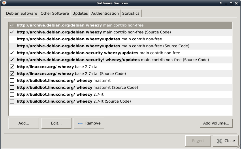

It looks like I was not supposed to add the additional archive sources. But rather just edit the base and security URIs per the instruction.
So I went back, removed the archive sources that I manually added. Then edited the existing base and security URIs.
I edited the URI and Distribution blocks. Now they look the same as the screenshot shown in Andy's post.
Here's mine after the edit:

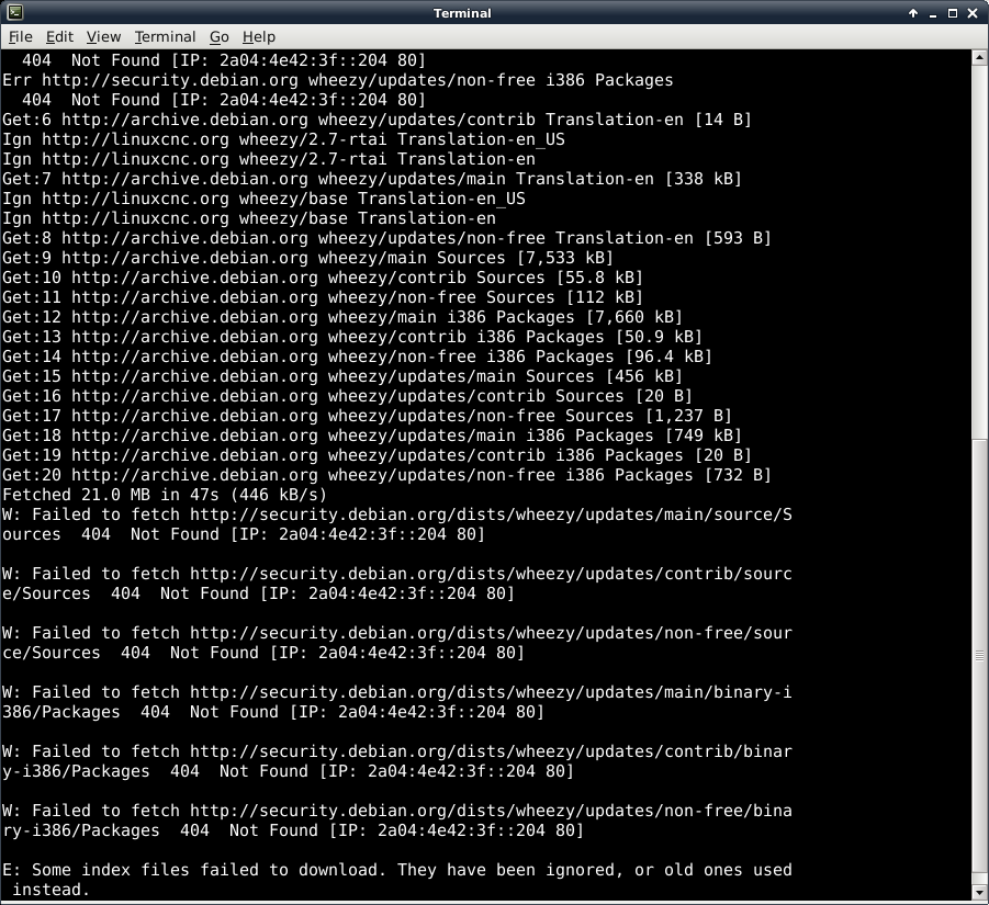

Then I run the command sudo apt-get update -o Acquire::Check-Valid-Until=false
I get some "Failed to fetch ... " errors and I don't know if that is normal or not. Here's a screenshot of that:

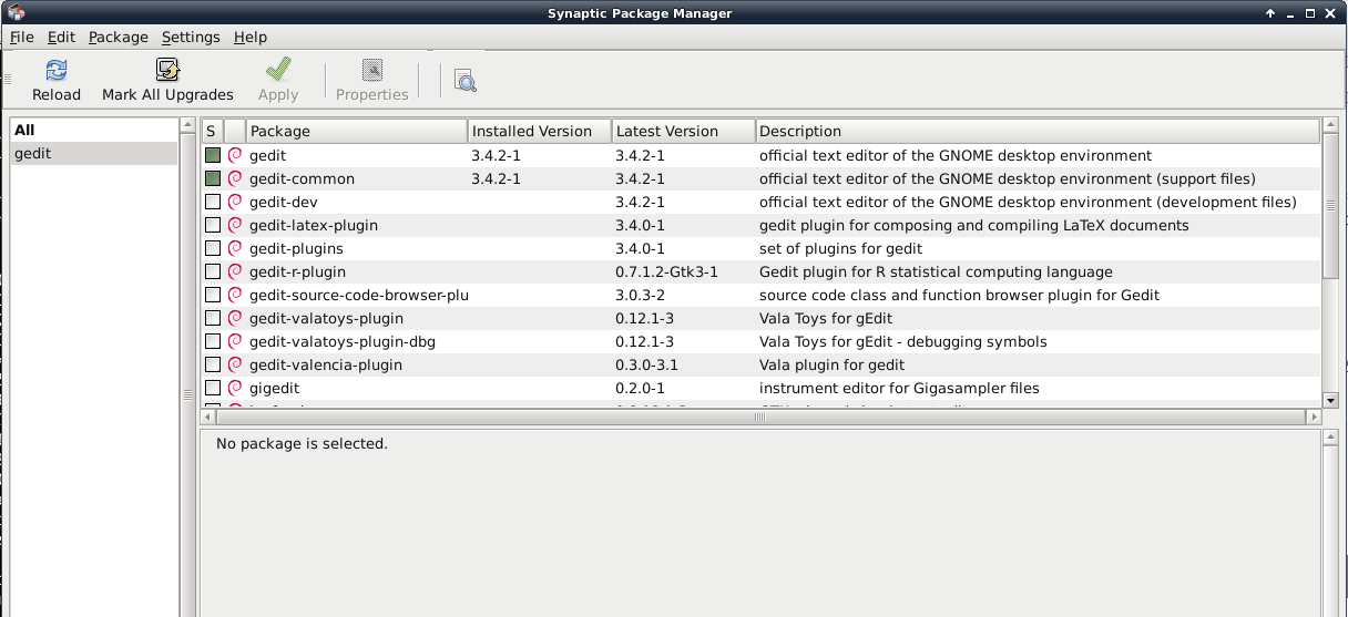

I am now able to install gedit though:

I do think the / after deb-src archive.debian.org/debian-security/ wheezy/updates main contrib non-free is not correct. I'll see if I have a Wheezy HD laying around and test that.
