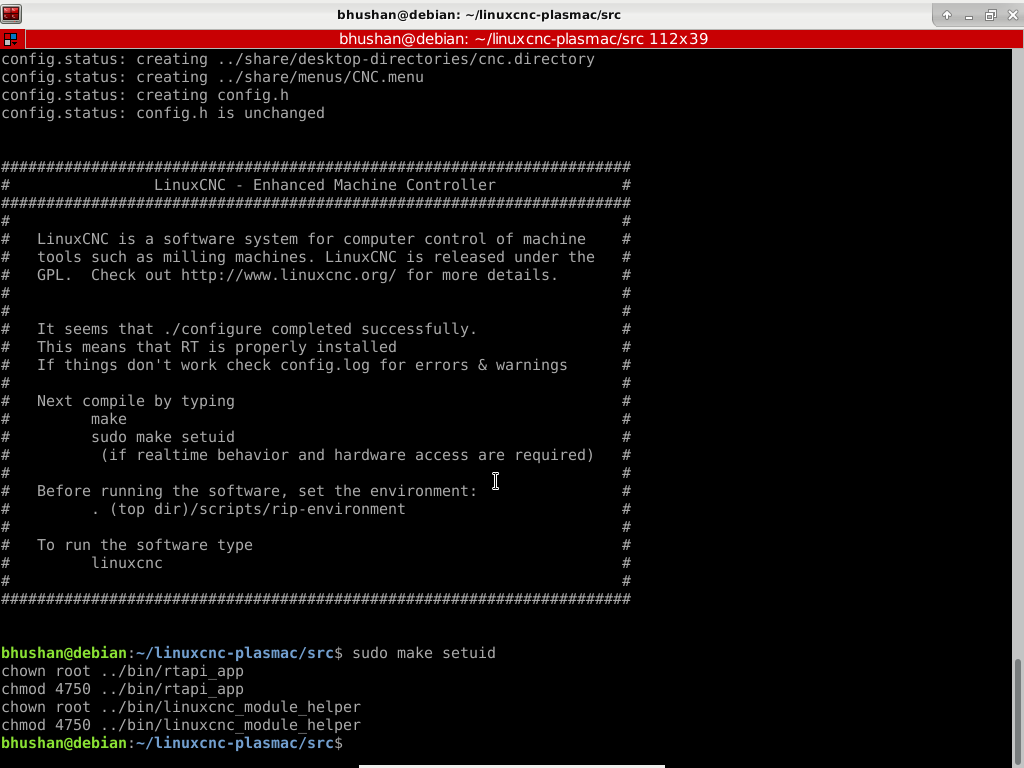

sudo make setuid problem
- phoenix
- Posts: 157
03 Jun 2019 01:20 #135697
by phoenix
sudo make setuid problem was created by phoenix
- Posts: 19904
03 Jun 2019 02:35 #135708
Replied by andypugh on topic sudo make setuid problem
That's all good. No error messages there.
But to run your compiled version of LinuxCNC you probably need to type
. ../scripts/rip-environment
linuxcnc
To start your run-in-place compiled version.
(and it is dot space dot slash, or dot space dot dot slash, depending on where you are relative to the scripts directory when you type the command)

03 Jun 2019 02:38 #135709
by pl7i92
Replied by pl7i92 on topic sudo make setuid problem
You ar up it is all fine
got to the build DIR (linuxcnc-plasmac )
in terminal
linuxcnc and it shout work as you expected
