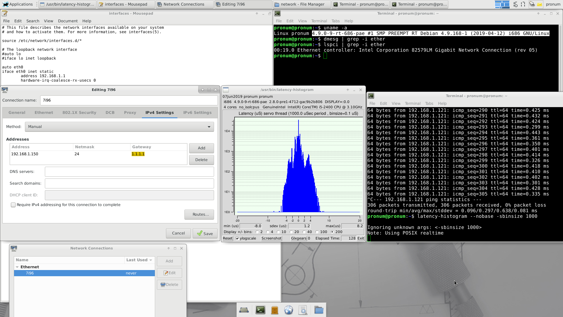

Hello,
I am using a 7i96 ethernet board with debian 4.9 preempt rt the version of linuxcnc is 2.8.
When I start the program it sends an error message to run latency test. I´ve just do that over an hour opening programs that i usualy work and then I had the same result the watchdog has bit. I can put it to false in terminal but it shouldn't be like that.
I attach the .ini
.hal
and a screen of the display with a ping in terminal
please help,
thank you
I attach the .ini
.hal
please help,
thank you

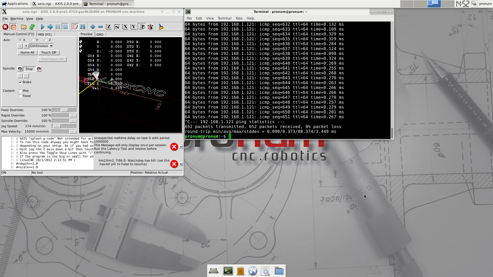

Hi pl7i92,
Thank you for your response,
That was a failed try to get rid of the error.
I've just put the value to 10000000.
And seems to be working but the error message : unexpected real time delay appears.
The watchdog not bit yet

The watchdog has bit again with the timeout ns in 10000000.
What can I do?
What can I do?

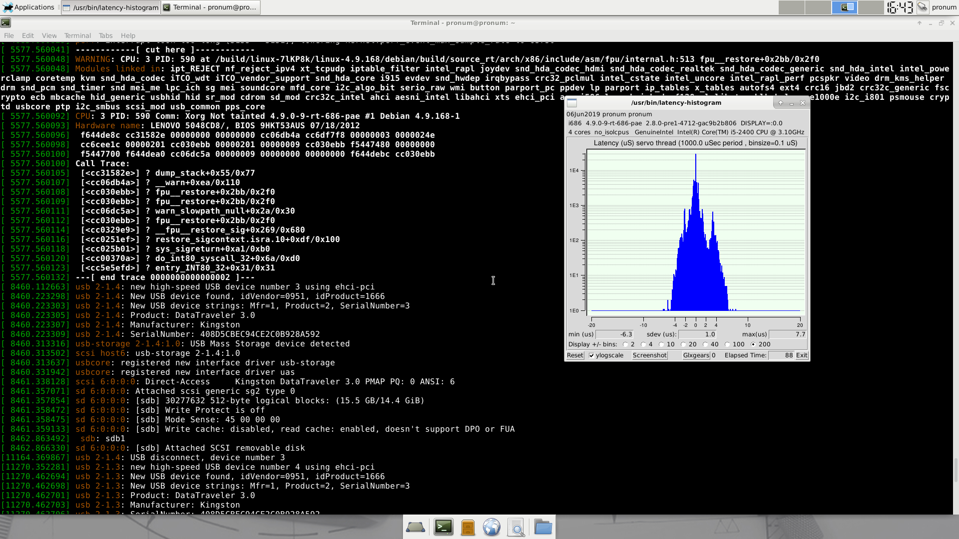

A closer look at your latency test shows that you are running RTAI, not Preempt-RT.
so network access will not be real time. You need to use a Preempt-RT kernel and
the uspace version of LinuxCNC 2.8 for the 7I96.
