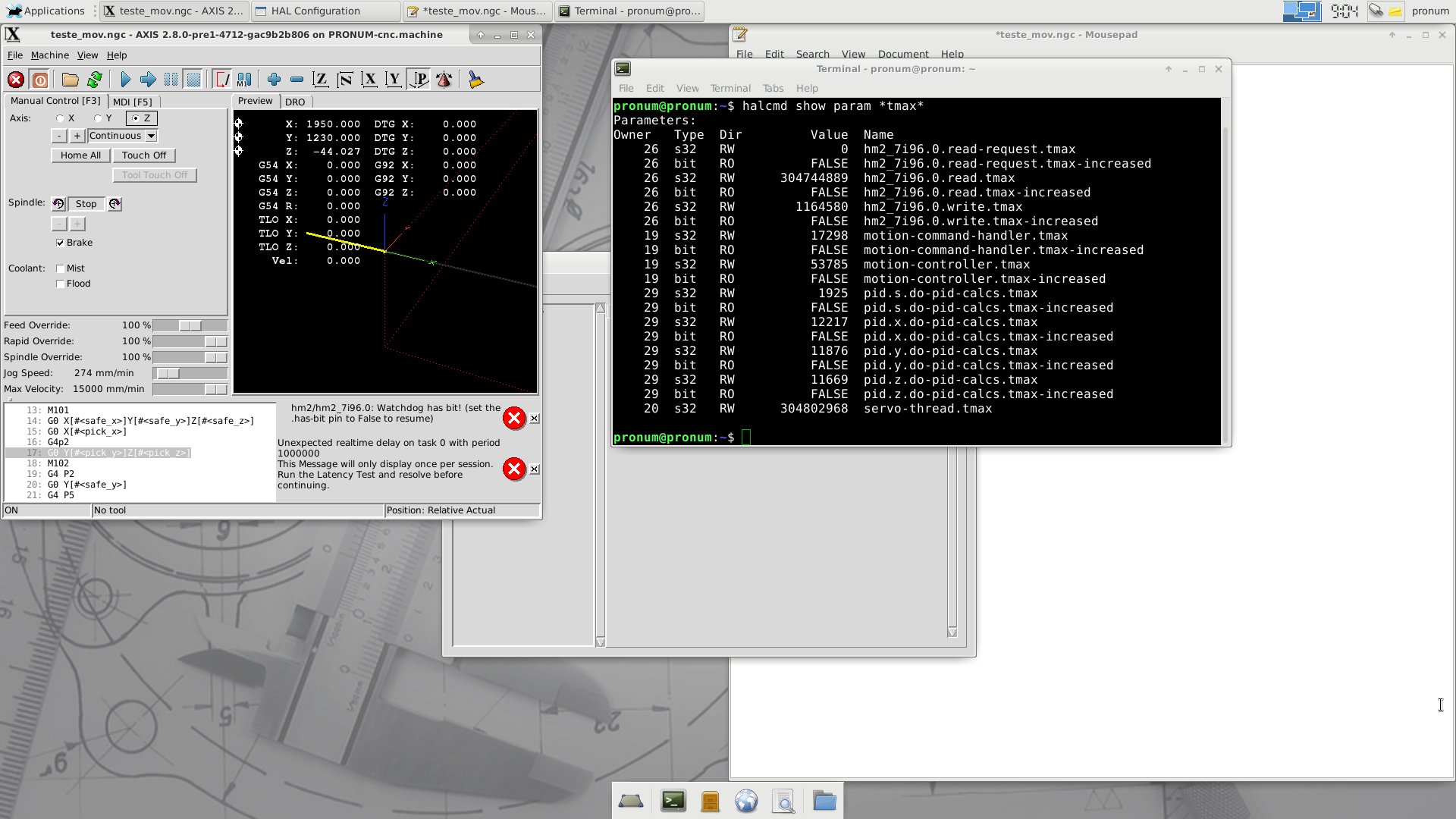

Can you check the kernel log (via dmesg) and see if perhaps the link has dropped?
This would be an indication of a Ethernet problem on the host or a power issue at the 7I96.
Another thing to do is check the hal function tmax values to see where things are hanging.
To do this, run LinuxCNC, wait for the error and then run this command from a terminal window:
halcmd show param *tmax*
and paste the results here (note that these times are in CPU clock cycles,
so the CPU speed would be helpful to interpret the results)

I try to dmesg and couldn't show correctly the values.
Restarted and show this
Then I was able to see some changes, not so often occur the error watchdog has bit, these time after running a gcode file watchdog has bit. But it has longer periods.
the CPU speed is 3.1 GHz. the tmax in terminal

So you can see that the read-time is close to 10 ms which likely means that something
hung in the Ethernet hardware or driver. I suspect it may be an issue with the
Ethernet chip on your CPU. I would try a add-in Realtek or Intel Ethernet card as a
way of debugging this.
Also there is clearly a USB issue of some kind that needs to be fixed.
Last edit: 12 Jun 2019 08:32 by PCW.
