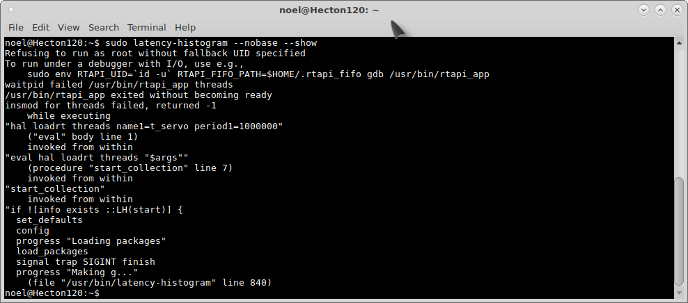

08 Jun 2019 21:41 #136308
by Roguish
What now? was created by Roguish

Replied by Grotius on topic What now?
It can be that you need to do : "sudo make setuid" in the src directory.
Insmod mean's your latency program can not load into the kernel.
But you are root now. And terminal output is complaining about your root session now.
Try to go back to user and then do your sudo latancy-histogram --verbose
command.
command.

Replied by BigJohnT on topic What now?
Why are you running the latency test as sudo?
JT

Replied by tommylight on topic What now?
Exactly what JT asked.
95% of the time it is not required to use "sudo", and using it causes some nice issues later on.
