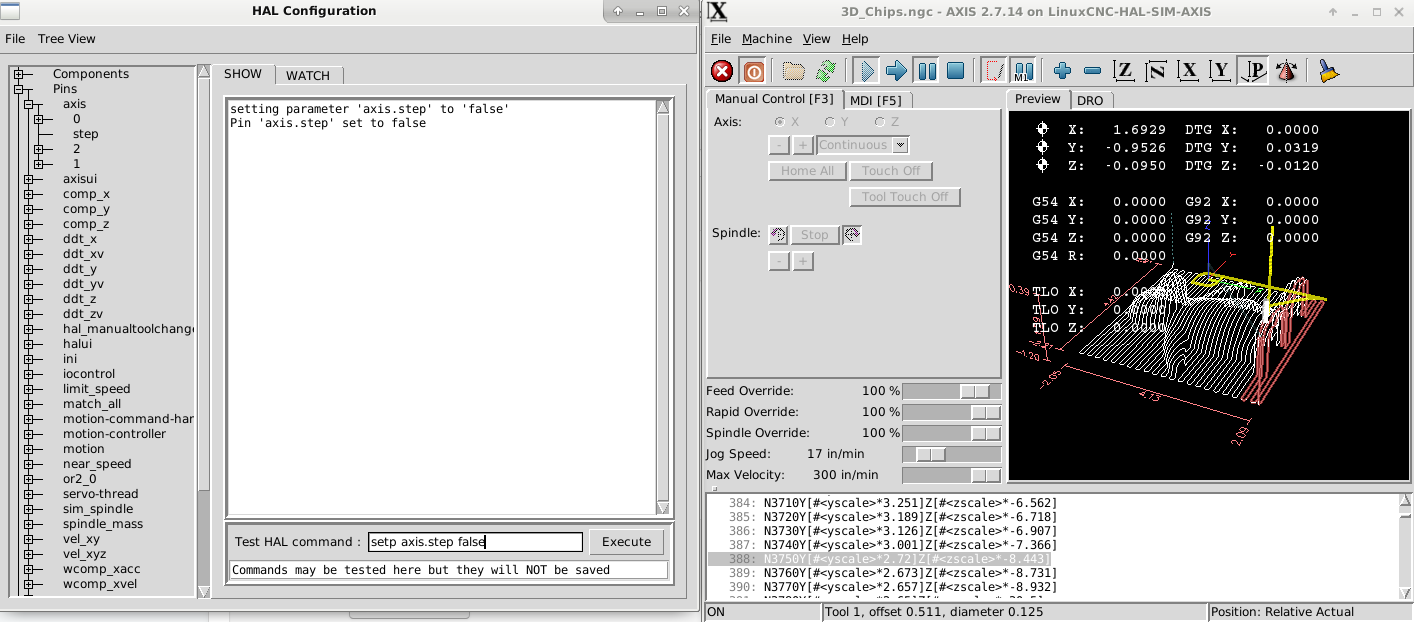

11 Jun 2019 13:40 - 11 Jun 2019 13:43 #136605
by Grotius
Replied by Grotius on topic Halui Component
The keyboard T button is outside of any halui connection.
I have made a little axis.py source code modification to make a program-step connection to any hal signal.
axis.py is located in c: usr/bin/axis
line 80 axis.py and add after this line :
h = hal.component("axis")
h.newpin("step",hal.HAL_BIT,hal.HAL_IN)
add after line 877 of axis.py add :
if h == 1:
ensure_mode(linuxcnc.MODE_AUTO)
c.auto(linuxcnc.AUTO_STEP)
Output is a hal step connection named : axis.step (you can see this in the section : pins => axis => step.
To set the step parameter true, type in hal : setp axis.step True
To set the step parameter false, ype in hal : setp axis.step False
When i test the step button T, i mention the machine has to be in pause.
So almost the same can can be used to set the machine in pause first. This can automate the process trough hal.
