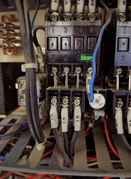

Hyraulic motor on the hydraulic pump that does my tool changer and tool clamp. The hydraulic motor comes on during power up, and stays on. Sometimes that little grey piece pops out. I think its arcing??? anyway this removes the three phase power to the motor.

Ok, That is the motor overload relay interrupting the power to the contactor coil. These are not instantaneous devises so the fault is a persistent one. The fault may be a hydraulic one (electric motor load is too great). The fault may be an electric one, motor failing. First check all wire connections, a loose connections can cause this problem. Check the actual electric motor running current with a clamp on current meter. Is the load for each phase equal? Do the results agree with the set point on the MOL? Now things get a little harder. Do you have a way to check the actual hydraulic load on the motor? This requires measuring both the pressure and the flow, not really easy unless you are setup to do it. The last thing is that the MOL may be bad or have a bad connection inside, some MOLs have "heater elements" that are sensitive to the motor current and if the connections are bad can cause a malfunction of the MOL. It is not unknown that the contactor may have a burned set of contacts that can make the MOL think there is a motor fault.

Does the hydraulic pump spin when it should?

It doesn't do it all the time. Now it is going on two days and it is ok. It only does it when power on the machine.
It never did this before. when it does it, I can just reset it and it goes ok when running.

It's one of three things, the overload is failing, the motor is failing and drawing too much current, or the hydraulic system has a problem and is overloading the electric motor and drawing too much current. Check the amps on each phase to see if they are even or not and below the FLA for the electric motor.
Edit: it could also be a loose wire which will arc and draw too much current.
