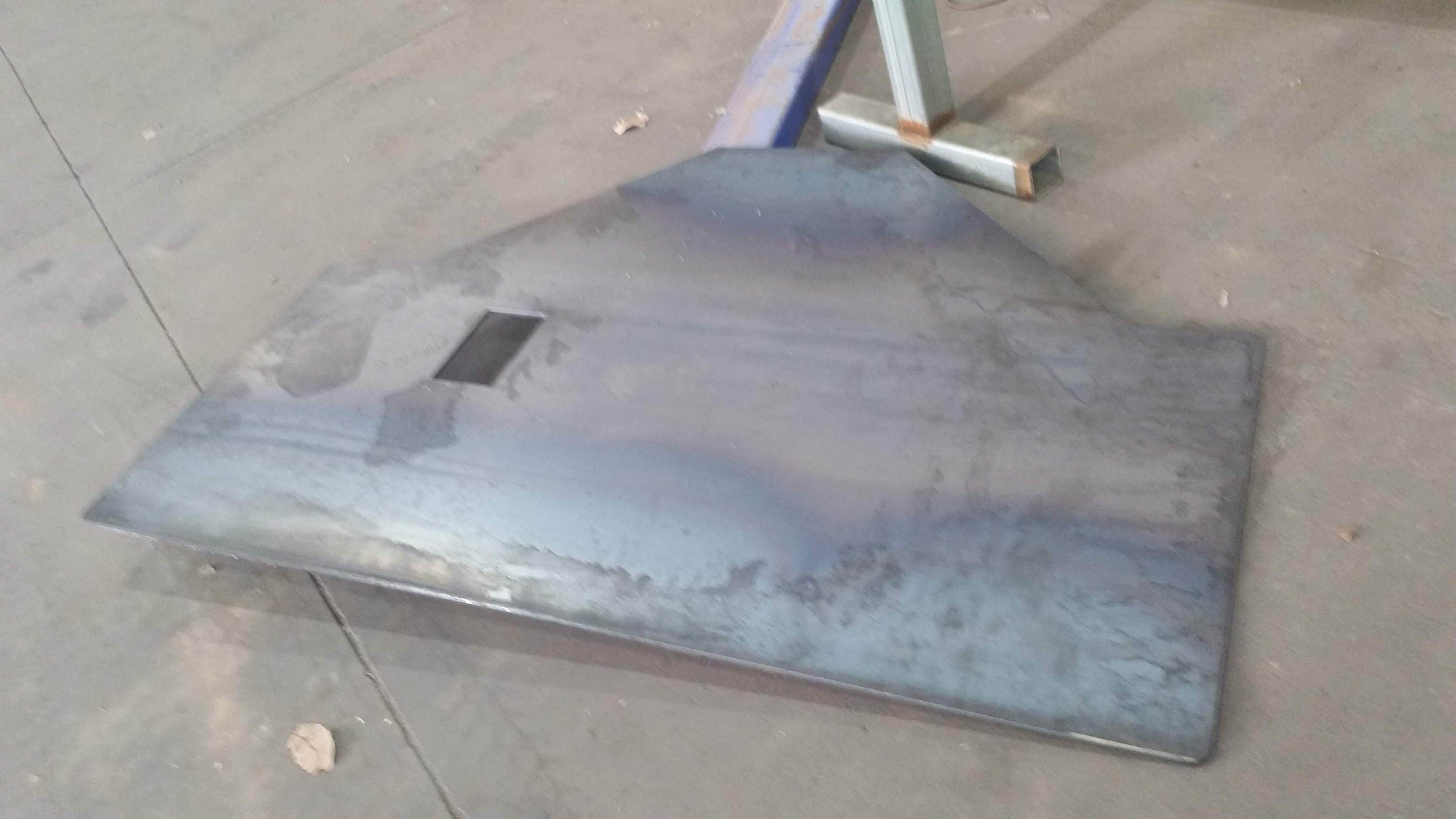

It looks like pncconf will create HOME_SEQUENCE entries if every joint has a home switch input defined.
Unless something is wrong. Did you define home switch inputs?
No I did not define any home switched,
When I built my machine I was so excited to get it cutting I did not install any home switches and never got around to it.
In CommandCNC they are not necessary to have the machine running as you can just home the machine in any position.
I cannot say I noticed any unsquare cuts from my machine. I have done alot of cutting with it and have not noticed any out of square parts from the gantry being out.
See below for my biggest part ive cut, It is completely square. Although my gantry is very tight due to its design and does not rack when moved by hand with the gear boxes disconnected,
Attachment not found

But when I think about it, unless I'm off the mark, you can't have a gantry without working homing switches.
In theory it seems like it is not possible but in reality I have done it for over a year successfully.
Maybe my parts are not as perfect as they could of been if I had home switches, I will look at installing them soon if I cannot get Plasmac branch to work without them.
It is really handy tho for a plasma to work without them. I understand the point of getting the Y axis gantry square but when I have multiple sheets on my table it is great to be able to jog to the position I want to start the program from, Home the DRO and let it run.
I do understand that is not how it works in the Mill and Lathe world but in the Plasma world, providing you are cutting multiple sheets at once it is much simpler to home in position rather than using offsets.
I have enough drama teaching my guys who have never seen let alone used a CNC machine before how to use the machine. It might not be the "proper" way to use it but in the real world it does work.
