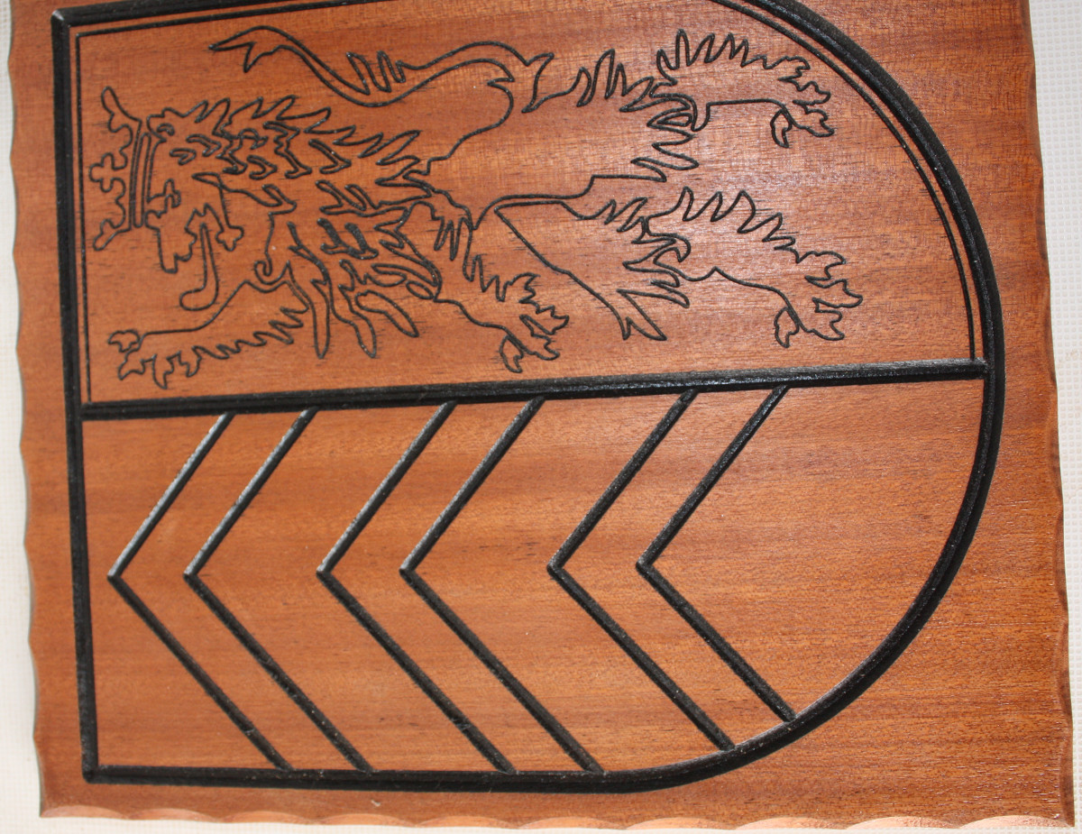

Hi welcome
Firsat
there is best practice to handle things on 6040
USE for every bit you got a separate FILE
part_x_6mmbit
part_x_vbit90
part_x_vbit60
part_x_xxxxx
YOU can add also a ORDER Letter
like part_X_A_6mm
B,C,D
THIS can be done in Fusion360 FILE per Operation in settings
USE order is a option
THEN
you can use a simple TOOL Zeroing Routine and work like that my YT
here it is a wood engrave with 4 files and bits
