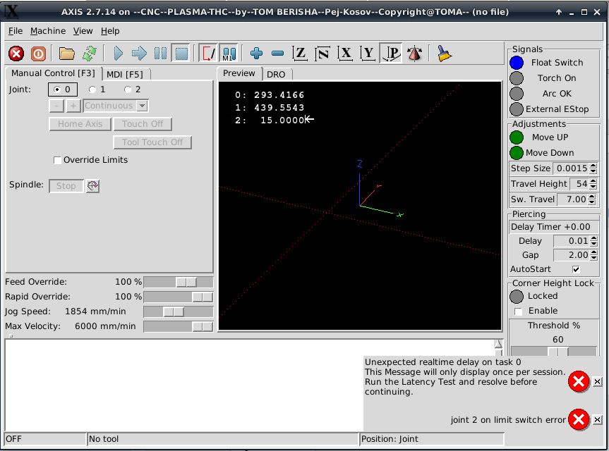

I am using thc Toma config
But it doesn't start machine untill arc ok is provided i mean by start is machine dont get out of estop even
After that whenever i try to jog anything
It says joint2 on limit switch error...
And machine turned off
How can i solve this
I don't have physical limit switch for axis

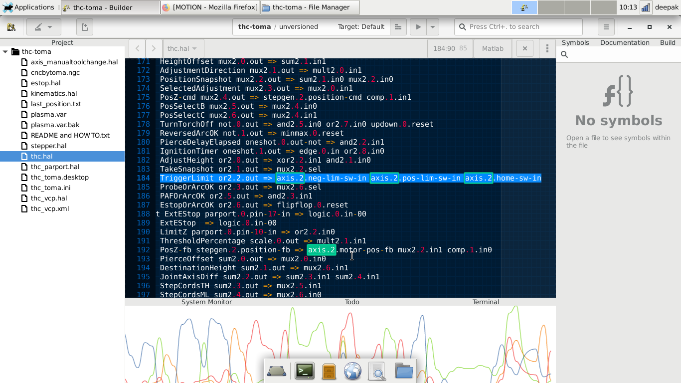

Thanks for your help but it doesnt seems working it still says join 2 limit switch error
There s z limit switch in hal on parport 15 in
But i doesn't connected anything to pin 15

02 Jul 2019 14:53 #138429
Replied by andypugh on topic Joint2 limit switch error
can you attach the thc.hal file, it's pretty much impossible to read from the screen grab.
- Online
- Posts: 22049
- Thank you received: 7509
04 Jul 2019 06:30 - 04 Jul 2019 06:31 #138612
Replied by tommylight on topic Joint2 limit switch error
That is not the problem!
Set the float switch as "not" !
Everything is explained in the hal file, where and what to edit.
There are lines for both types there just ommit the one you do not need and uncomment the one you need.
