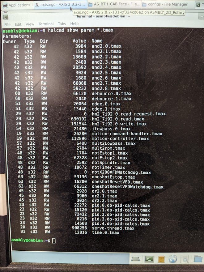

Can you run this command (in a terminal):
halcmd show param *.tmax
After LinuxCNC has been running for a long time
and post the results here (along with the CPU clock speed)

- Posts: 18080
- Thank you received: 5316
07 Aug 2022 16:39 #249285
Replied by PCW on topic Unexpected realtime delay error message
You might try setting this higher:
setp hm2_[HOSTMOT2](BOARD).0.dpll.01.timer-us -50
say to -100 or -200 usec, because your system may have relatively
poor latencyso the DPLL baseline wander is more than -50 usec.
The following error limit is set low enough (0.0002 inches) that
a small timing error (~133 usec at 15 IPS) will trigger a following error
Too low of a DPLL sample time setting can trigger cause this timing error

07 Aug 2022 17:11 - 07 Aug 2022 17:12 #249287
by dannym
Replied by dannym on topic Unexpected realtime delay error message
Anything to see here? It had been running awhile, but just slow linear passes to cut cabinets
Last edit: 07 Aug 2022 17:12 by dannym.
