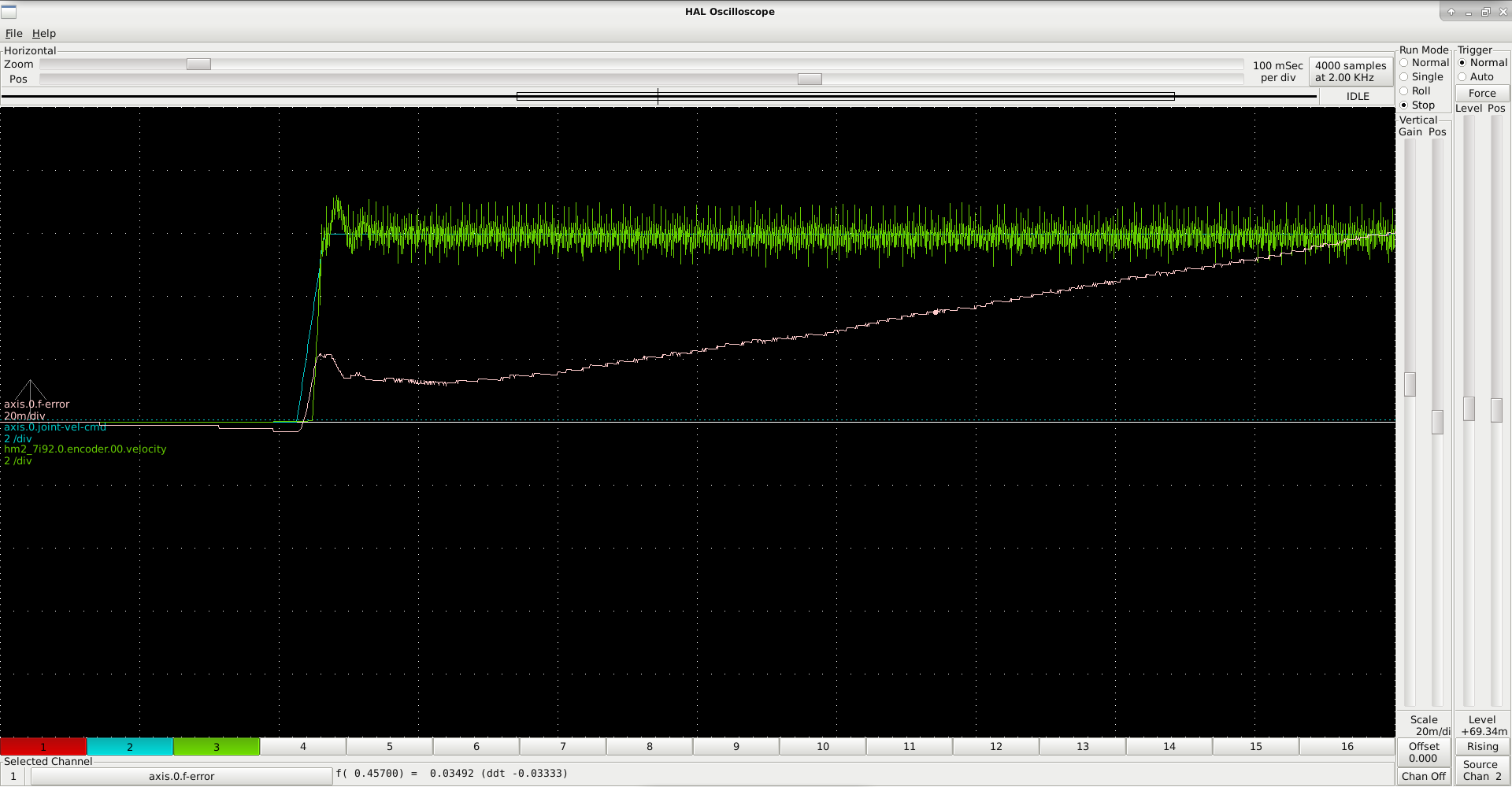

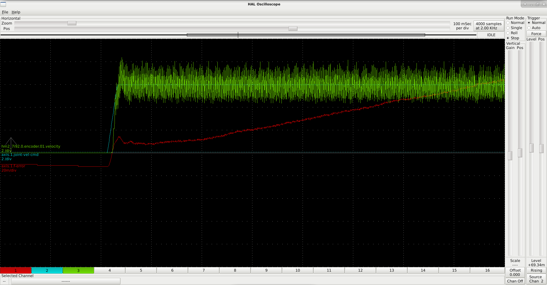

pid.command-deriv was disconnected, velocity at 10V was measured in open loop and entered into the .ini, and PID parameters were set to FF1=1 and P=0 and now behaviour is as expected. See the following commanded/feedback velocity and f-error graphs for jogs on X and Y with the new settings.
As you can see the velocity is quite noisy, which was true during open loop testing too. Should I fine-tune FF1 somehow to make sure it is exactly correct or is it enough to have it almost right?
Now I'm also wondering if you have any good tuning strategies for the rest of the PID terms for velocity mode drives, starting from a correctly set FF1 parameter.

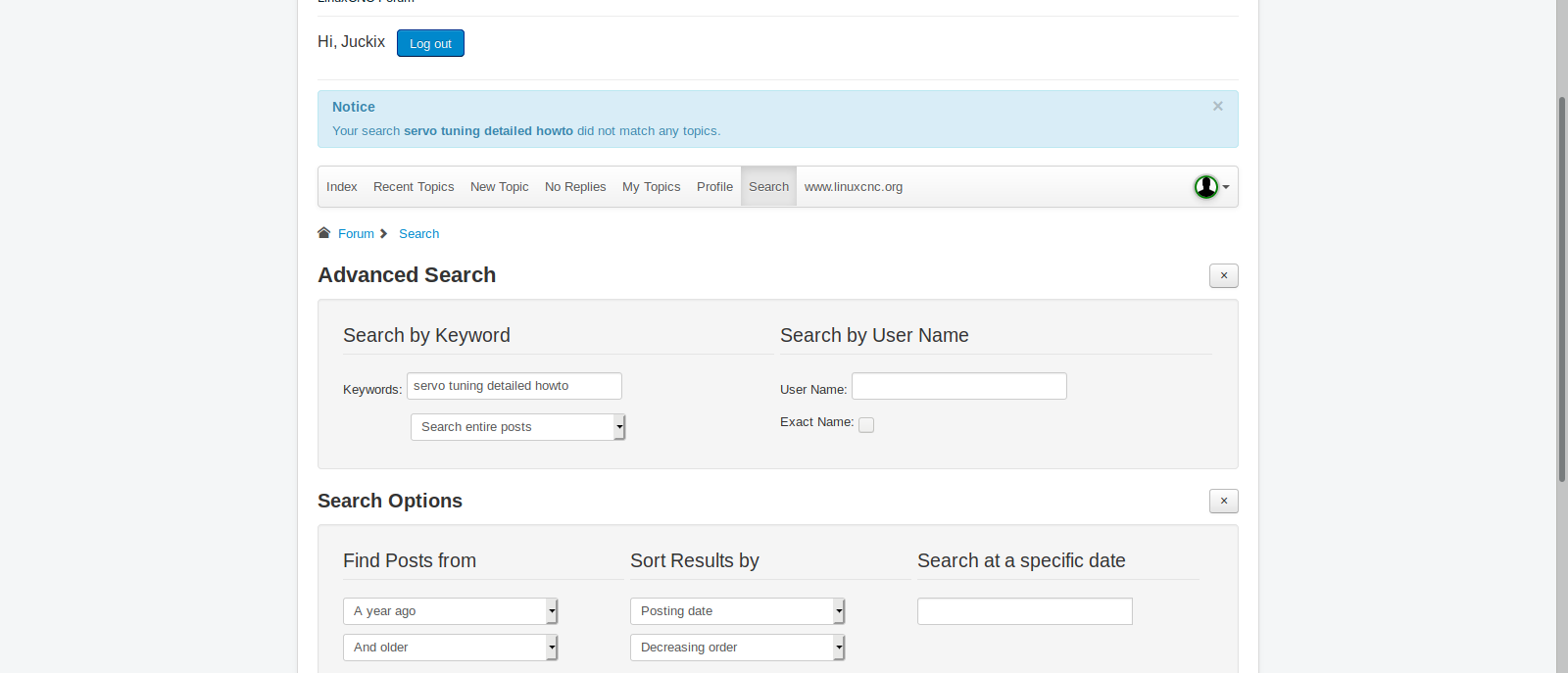

18 Jul 2019 12:12 #139793
by Juckix
Haha well not exactly that.
And well I did look around the forum before asking and found some stuff, including a detailed guide by you I believe. But the issue is that many of them directly contradict each other, so I thought I would ask for a straight up recommendation.
Replied by Juckix on topic Odd velocity mode servo tuning issues
Search the forum for "servo tuning detailed howto", plenty of detailed info about tuning servo drives with Mesa 7i77.
