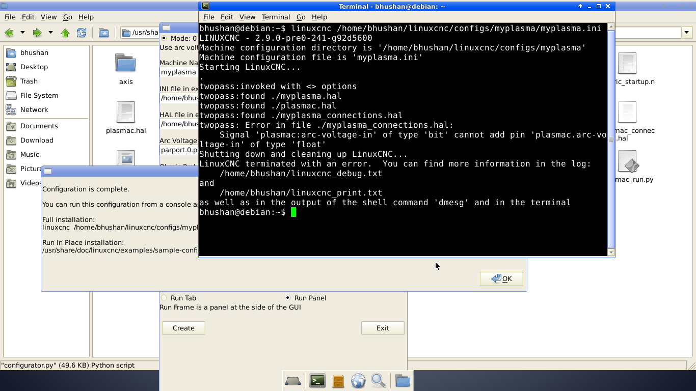

I'm gona give friquency input to in
What you mean by hal name of parport pin i entered parport. 0.pin-n-out
Is it right???
Is it right???

I did as u said its giving an errro
Can not find - sec task - var task - num 1

It would be parport.0.pin−<n>−in or parport.0.pin−<n>−in-not.
I don't know what that error means.
If you are using a frequency then you probably need to feed that into an encoder then use the velocity output of the encoder for the arc voltage.
Are you using a THCAD?

I didn't connected it to my parport physically
I'm using diy circuit
But leave that as it's other topic
FOR NOW I JUST WANT MY AXES TO JOG INSIDE PLASMAC... EVEN A SINGLE AXES JOG ALSO ENOUGH

Can you post your ini file and ALL your hal files and I will have a look tomorrow.

I would be of great help if you post the base_config.ini file & it's companion HAL file. Followed by the files that are generated by configurator.py

i edited ini file and tried again it still terminated with error
