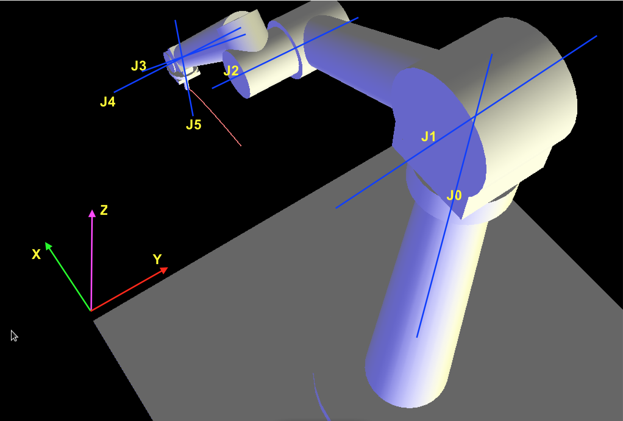

Hello there,
I've been reading and struggling with this for quite a few time now, and there are a few things I can't get, if you don't want to read this all, I have added 3 questions at the end.
In my previous question here there was some discrepancy because I see a 6 degrees robot, but someone told me that PUMA should be 5 degrees robot, but I still see 6 joints and after some research in the code and HAL and puma configurations I couldn't find where the geometry is defined (except for a few parameters).
I will explain what I did , and how I did it.
PUMAKINS
To learn more about the geometry I have add some debug information inside pumakins.c so I can dump information about the joints and the EmcPose... I created a very simple function:
And added that at the end of the kinematicsForward method so I can see what is going on, and after some depuration of the output I got this xls file with the joints and world positions:
Spreadsheet
I only moved the X axis positively, so the kinematics should be like 2d robot, and that's true because only J1, J2 and J4 (joints) moved to keep the tool moving in the X axis.
So, based on the vismatch simulator I drew so I can understand how is the coordinate system and the joints:
Everything makes sense except a few things, so...
PUMAKINS
void dump(const double * joint, EmcPose* ptr) {
printf("J0,J1,J2,J3,J4,J5,x,y,z,a,b,c,u,v,w\n");
printf("%f,%f,%f,%f,%f,%f,", joint[0], joint[1], joint[2], joint[3], joint[4], joint[5]);
printf("%f,%f,%f,%f,%f,%f,%f,%f,%f\n", ptr->tran.x, ptr->tran.y, ptr->tran.z, ptr->a, ptr->b, ptr->c, ptr->u, ptr->v, ptr->w);
}And added that at the end of the kinematicsForward method so I can see what is going on, and after some depuration of the output I got this xls file with the joints and world positions:
Spreadsheet
MY QUESTIONS ARE:
- Where is the PUMA geometry defined? (link sizes, offset and relative angles between joints)
- When homed , all the angles are ZERO, so it looks like they're showing the movement on each joint instead of the axis itself. Why is that?
- Can I assume the tip of the tool is perpendicular to the X axis here?
THANK YOU VERY MUCH!

- Posts: 19888
- Thank you received: 4646
27 Jul 2019 18:16 - 27 Jul 2019 18:17 #140758
It would be great if Vismach followed Genserkins, but at the moment Vismach and Genserkins move the robot independently. Vismach does not use kinematics, as such.
Gensekins defines the robot geometry using Modified Denavit Hartenberg parameters. That defines the joint lengths and the orientations of the joints.
Replied by andypugh on topic PUMA geometry
where is the geometry defined?,
Last edit: 27 Jul 2019 18:17 by andypugh.

28 Jul 2019 08:46 - 28 Jul 2019 08:47 #140795
by deanforbes
Replied by deanforbes on topic PUMA geometry
There have been some discusion on the forum in the past that may help you
forum.linuxcnc.org/38-general-linuxcnc-q...nto-linuxcnc?start=0
forum.linuxcnc.org/10-advanced-configura...config-picker#109454
A group of us got an arm working some time ago - it is a 6 axis arm but I believe only 5 are referenced in the file here is the code that was used if you want to use it as a sample/reference to work from
github.com/deanforbes/Staubli_RX60L/tree/master/Linuxcnc/RL
github.com/deanforbes/Staubli_RX60L/tree...avit_hartenberg/Ross

29 Jul 2019 15:16 #140889
by felixcnc
Replied by felixcnc on topic PUMA geometry
Thank you very much indeed. I think this is EXACTLY what I was looking for, I will have to read this carefully, because at first sight it looks VERY interesting.
The PDF is VERY clear to determine how the DH parameters are set, now I have to read all the configurations (hal + ini).
Thanks again, I really appreciate this, because I think this is an incredibly good foundation stone for all the work I have to do with this.
THANKS!
THANKS!
