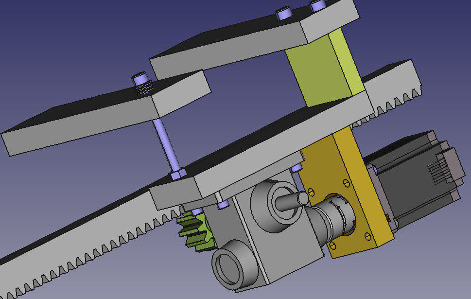

I have setup my machine and I got motion but I am trying to figure out the configuration on this. I am coming off of Grbl with my router but I am trying to find out what the pitch and revolution for a rack and pinion setup? I have stepper motor with a 12 tooth pinion with no reduction just 1:1 on a 20 pitch gear rack. Can someone help me out with this?

The drivers I am using are tb6560 and I could move them down to 1/8 step cause yes they are vibrating when I run a test gcode. The pinion is a 12 teeth and rack is a 20 pitch and they are direct drive.

I counted the teeth on a 1 inch margin and it’s 7 teeth. I entered the number on the configuration the measurement on the 2 lines I made and it equal out to 1.86” so I entered that and when I ran a command to move x axis 5 inches it was going way too far. So I kept tuning the number and I got it to be almost accurate with a value of .54 not sure how that is or if there is another configuration I need to make?
