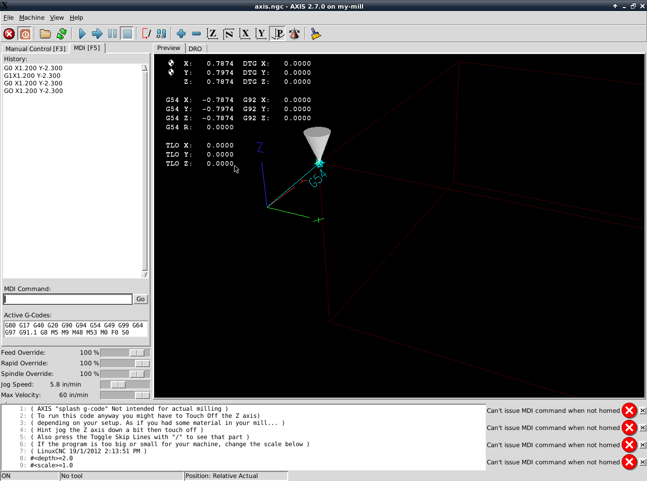

DEAR SIR
OUR SHERLINE CNC MACHINE COULD NOT WORKING HOMING CONDITIONS.FIRST I SET PARAMETERS IN LINUX STEP CONFIGURATION
AFTER SET THE VALUES OF HOMING VALUES OF X AND YAXIS IN MANUL CODITION.AFTER THE RUN IN THE PROGRAM
ITS SHOW CANNOT ISSUE MDI COMMAND WHEN NOT HOMED ERROR
THEN HOW DID CORRECT THE ERROR

Replied by tommylight on topic our sherline cnc machine couldnot working homing conditions
Home the Z axis.
