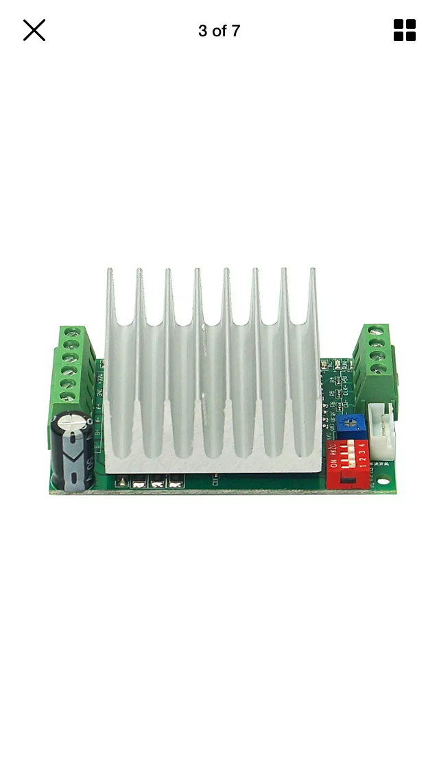

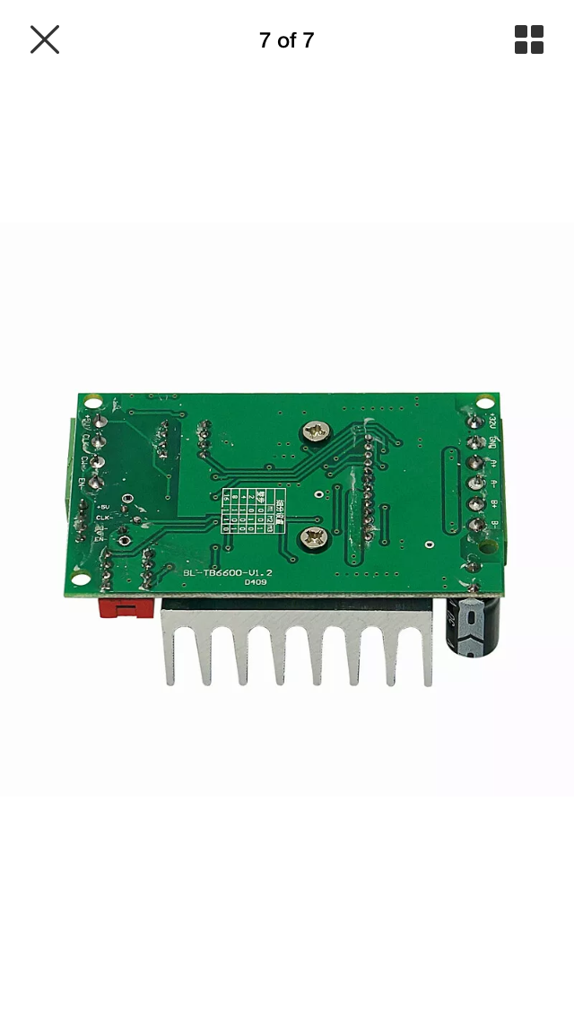

Here are some picturesPls read the relevant TB6600 manual how to connect!
Easier for you to read as you know what version of driver you have.

When you power the drive, can you spin the motor by hand ?
If yes, read the manual.
If no, set the step_time and step_space to at least 15000.

Can’t turn when power on.

In the ini file set :
Base_period to 100000
Step_time to 15000
Step_space to 15000
Save
Start linuxcnc.
Step_time to 15000
Step_space to 15000
Save
Start linuxcnc.
