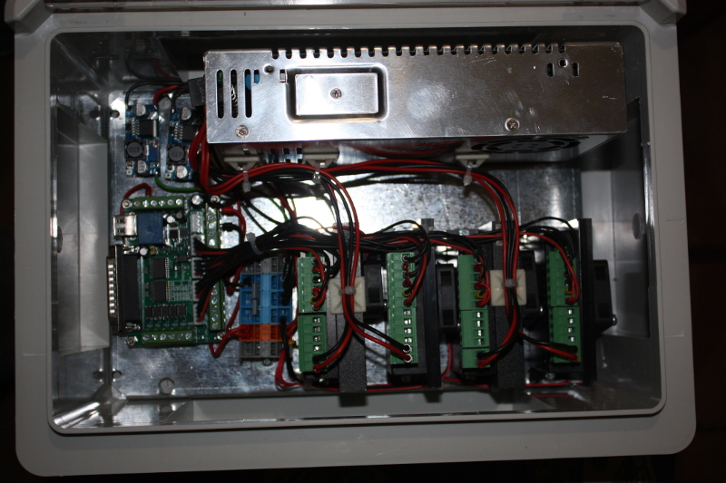

I fried my chinese CNC- breakoutboard by letting my machine run for about 4 hours without moving the drives. Very likely it was a grounding problem.
My Setup:
- BoB connected to PC via LPT
- BoB powered via USB cable from PC
- PC not grounded to my CNC electronics.
- BoB Inputs powered by an external powersupply on 12V; ground not connected to any other ground. I think this fried the board. Only possible if the input circuit has no ground connection to the rest of the board, right?
- Drivers connected to a Chinese 36V powersupply. DC ground and AC ground connected
I think the potential of the Input- Circuit powersupply drifted away from the powersupply of the PC or the powersupply of the drivers. My questions are pretty obvious:

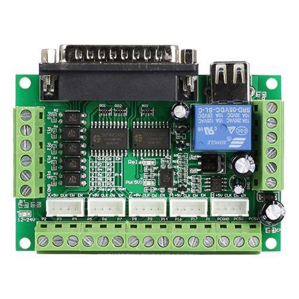

thanks for the quick answering. Sorry I wasn't aware there are several BoBs on the market.
I have the mach3 5axis BoB (see picture). By saying it is not recommended you mean the board is not recommended? If you are referring to the wiring, how can I wire the board correctly. Should I preferably get the 5V and 12-24V from a step down converter connected to the main PSU? Doesn't the ground leep exist even in that case since LPT has a ground connected to the PC as well?

What fried?
I don't see any disadvantage of powering the 5V side from USB since the 5V common is PC ground anyway.
The inputs and analog section 12/24V is isolated from the PC so you can power these as you like.
I would not connect any of the input/analog common pins to PC ground

14 Sep 2019 19:51 - 14 Sep 2019 19:56 #145169
by Louis Cypher
Replied by Louis Cypher on topic China- BoB grounding questions; how to correctly power the board
Sorry for the long time for debugging. Have been on holidays. I started debugging and it appears to me that the PC was damaged. It crashes after a while regardless whether I run from a live disk or from the hard disk even if disconnected from LPT and USB. Whenever it get's stuck all USB devices die.
When I power the USB and my PSU as well as 12V all three LEDs on the BOB are on. When the PC boots the lower LED (further away from 5V relais) is switched off. The relais of the BoB goes on ond of a couple of times on a pretty high frequency. Maybe the relais consumes too much power from my PC and damaged the USB of the PC?
If everything is on, but PC off, all drivers appear to be running fine.
I am afraid to damage one more PC if I swap computers (I have a spare one left). Should I run the 5V from a step down converter? How should grounding of that step down converter be done in that case?
Thanks in advance for your appreciated help (starting to get frustrated; my machine has been already running, now I am thrown back a couple of weeks I guess)
Last edit: 14 Sep 2019 19:56 by Louis Cypher. Reason: typos

OK, first findings:
The Chinese Mach3 CNC BOB consists of three separated circuits. Hence, to my understanding:
- ground of those circtuis should not be connected at all (I connected everything with everything)
- The input circuit should be powered via USB or from the PC PSU to keep input signals separated from the rest. Using a step down converter to generate 5V from main PSU can fry your PC since it connect circuits that are inteded to be separated.
- Read the best wiring practices twice as well as the manuals of your components.
- Make a wiring diagram and use different colors for different grounds if you can
